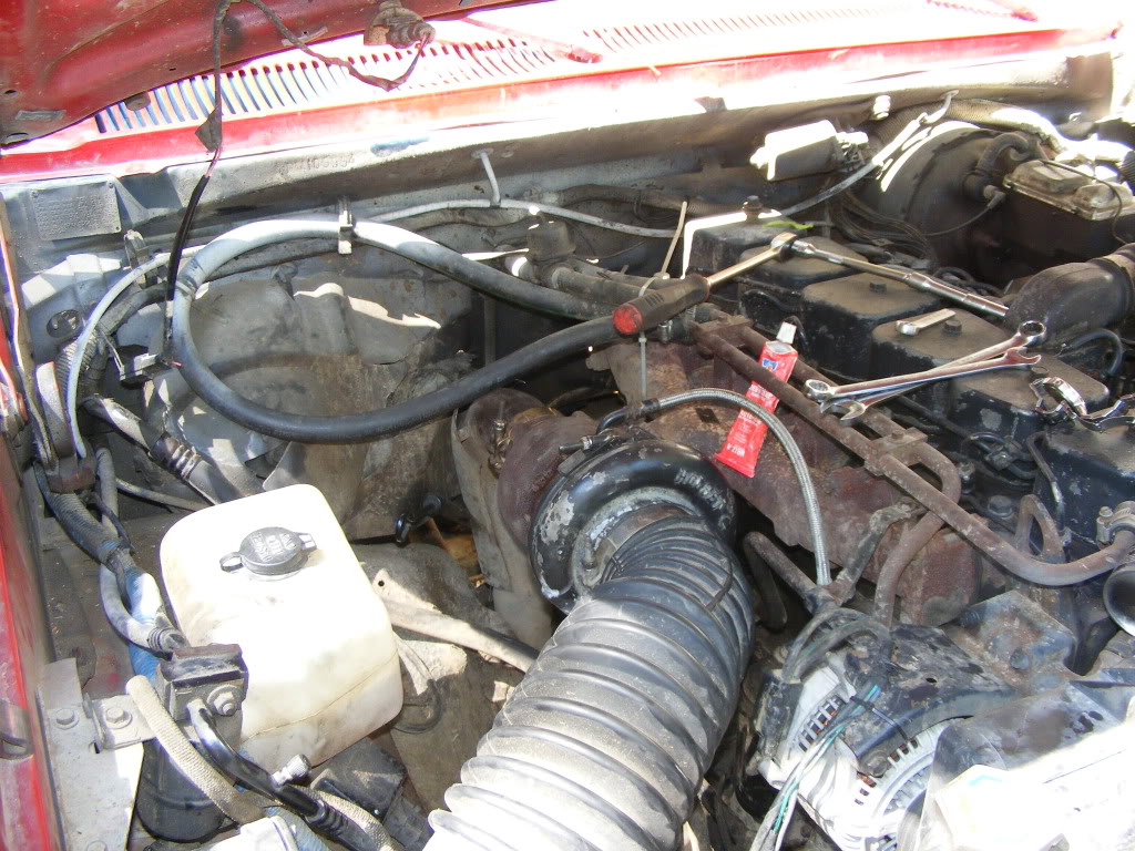

intake pipe comes off
take off the clap holding the elbow to turbo houseing

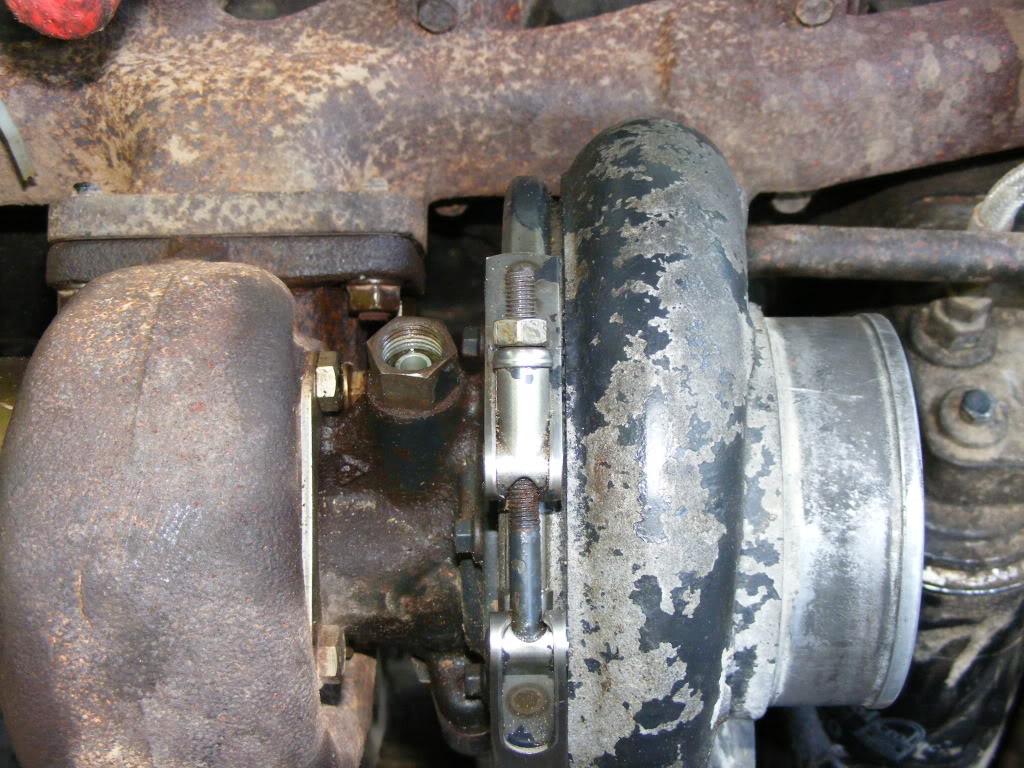

now on top there the down pipe clap,oil line and 4 15mm nuts that hold turbo to exhaust manifold
use 19mm rench for bottom part of oil line and 5/8 rench to undo the oil line fitting useing 2 renchs keeps the bottom fitting from turning and watch closely to see that the fitting on the oil line is not rusted together or else u will wreck the steel part of the oil line if it rusted spray WD-40 or something alone those lines to help it free up or just tap the oil line and fitting will turn

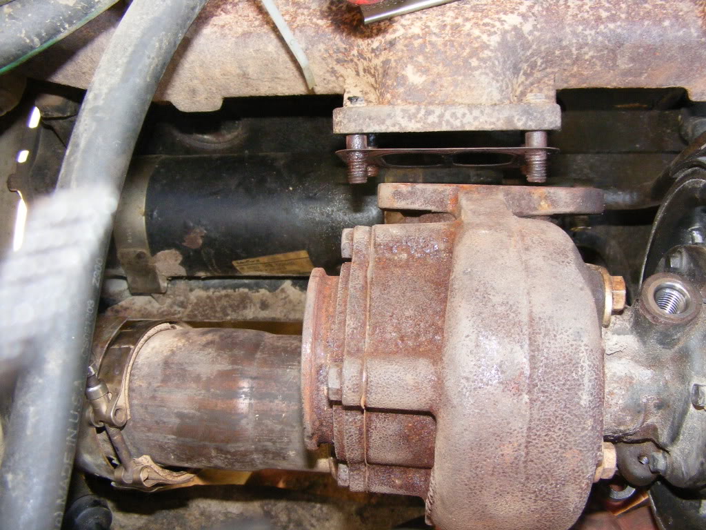

u can see that the WH1C is little long thats why u undo the bolt on the down that attaches to the tranny see (pic above in the 1st post) just push the pipe back and slide the new turbo on

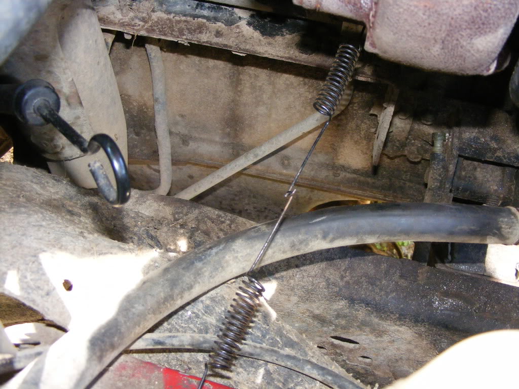

i jimmy riged a clip and some springs and attached to the waste gate to hold it shut and the other end went to some hole that was on the inner fender i had another one b4 this but it wasnt strong enough and made me loose boost u can make ur own anyway u want just keep gate closed for full amout of boost
