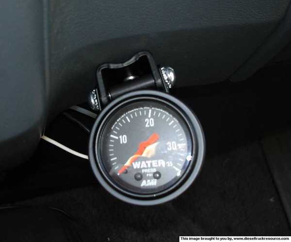

Here's my fuel pressure gauge. Cost $10, it's been in there about 2 years.
