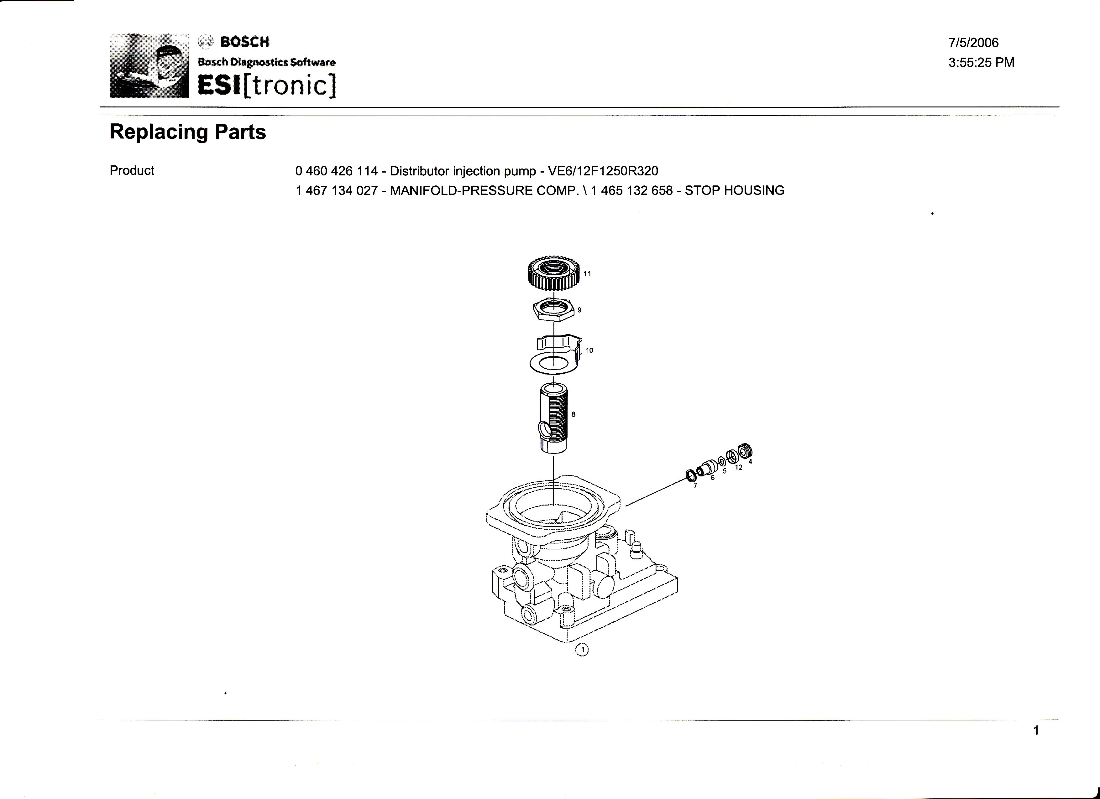

Posts: 19
I think this is the diagram I need. But I don't see the fuel pin in the picture.

From: hesperia ca.
go to the sticky at the top of the 1st gen forum page and scroll down to engine section, and find "leaking fuel pin" some good pics, the last one I did, the seal sat just behind the hex plug.
