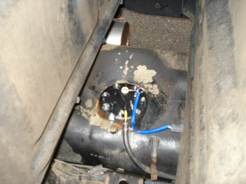

Originally Posted by dodgenstein
I pulled the bed off when I did mine.
I had to do that with my Toyota, as it was a real PITA to pull the tank. My dodges were relatively easy once the fuel was nearly empty.

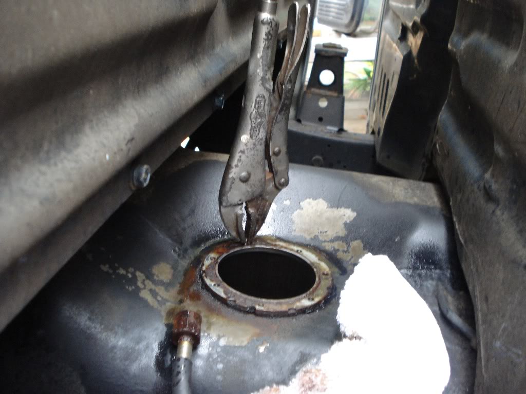

The bolts were frozen, and my torch wasn't working at the time...

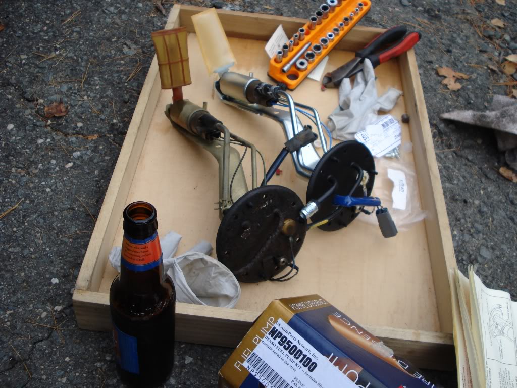

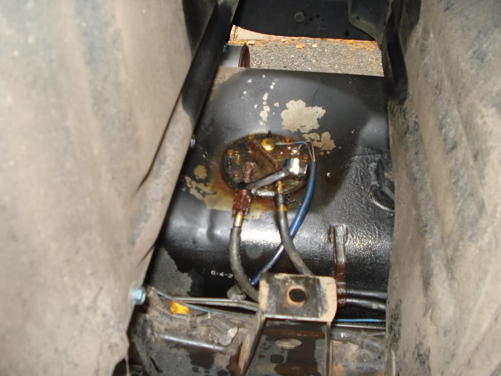

Everything was replaced due to rust
