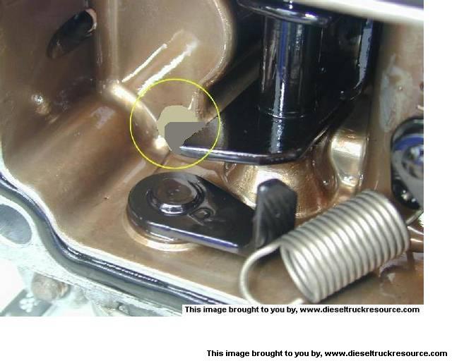

How much meat did some of u take out of your pump Top? Just wondering how much smoke are u putten out? Im putting a 366 spring in a nother 1st gen tonight Im thinking of doing the grind to the afc housing. Give me some info please Thanks Tboling I did my butt how far can u go?

Here's the standard I follow:
I made a straight line out of it, just like Wannadiesel's edited photo shows.

i just did mine last week and took it all the way flat with the rest of the lever. like the picture

Smoke: If you mash it with low boost, the truck will smoke heavy until boost builds. You can drive clean if you roll into the throttle slowly until you have some boost, then you can get on it.

This (assuming the picture works . . .) is what I would suggest. I have been meaning to do it for some time, just haven't been able to get to it, so, it is as yet un-tried. However, based on the geometry of the levers in there, I think that you can get all of the full boost fuel, without having to drive with your tip-toe to keep from pouring unburnt fuel out your exhaust . . . If I am wrong, you can always take off the extra material later . . .
To make as much smoke as possible go for the flush grind, like Dave's picture above.

I only ground mine 1/2 way off, and my smoke looks like this:
Thats with 366 spring, AFC lever ground, and about 2 turns on the fuel screw.
