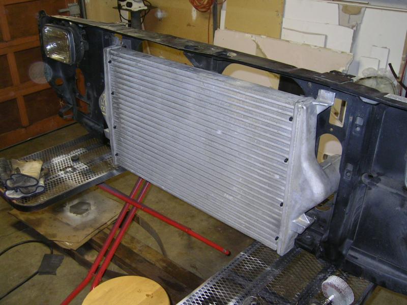

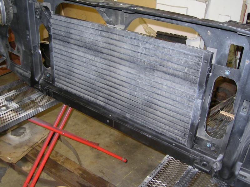

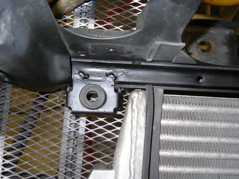

I had done the A/C condenser trimming, and remount last year. So I just removed it to check everything and make sure it wasn't rubbing on anything.
Here you can see how much room I have on either side of the IC and those brackets.
Trimmed the top of the upper mounts on the IC....

You can also see in the A/C condenser pic the trimming I had to do on the rad support. Tried to keep it to a minimum.
And the IC in place...

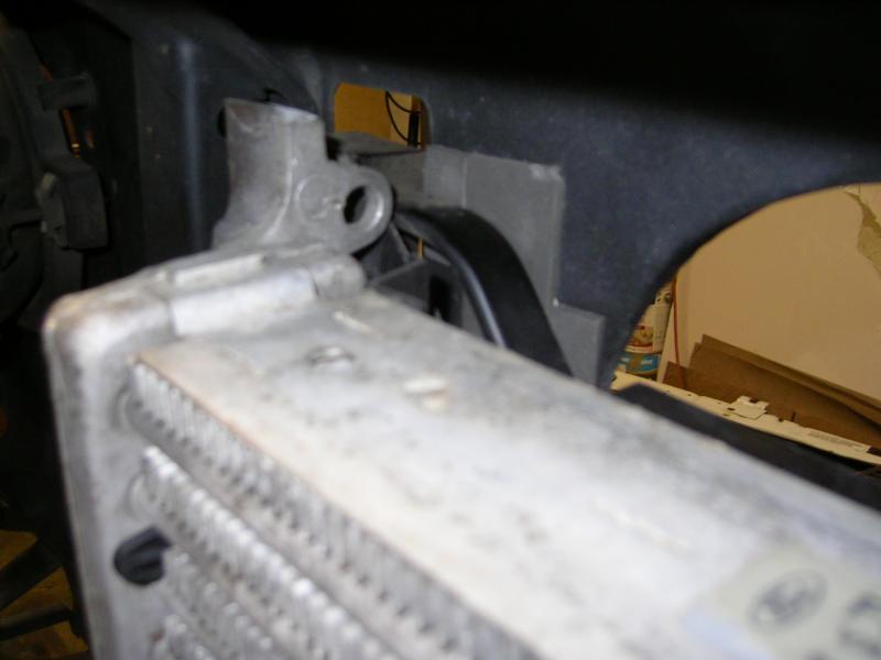

Had to trim this lug off to clear the A/C line connection....

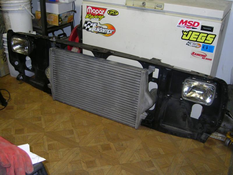

And it's basically in place now. Just need to fab up the mounts.

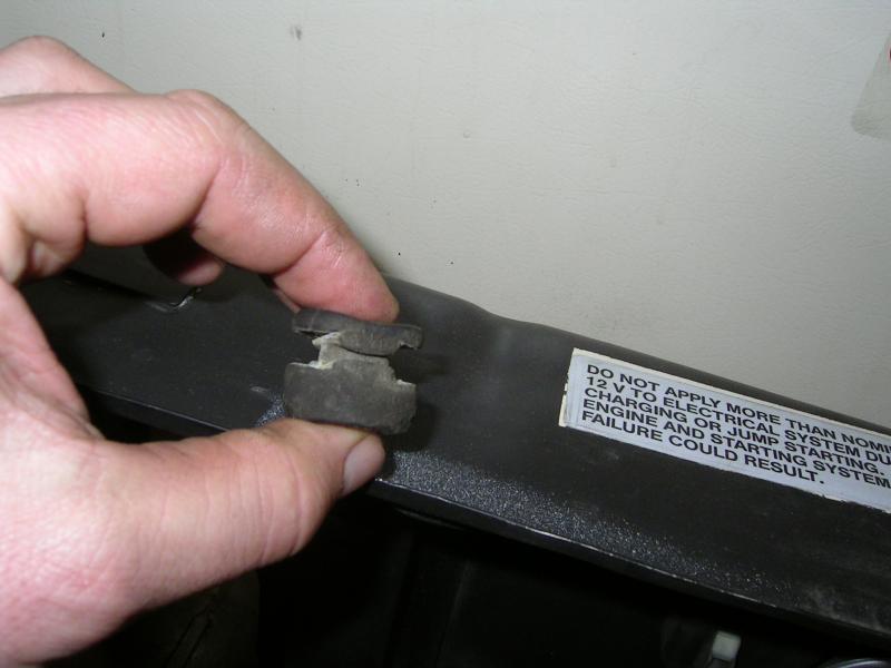

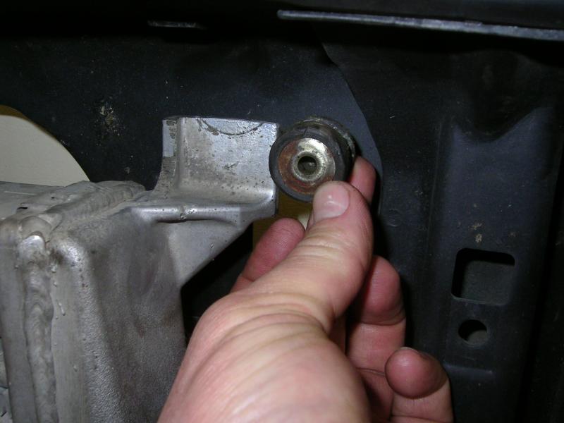

The lower mount will use the stock pocket and then run over to the bracket and bushing.
And the upper mount will use the original bushings from the OEM IC.
I will slot the aluminum tag and slip these in like the original ford bushings. Then fab up some brackets to hold it in place.
