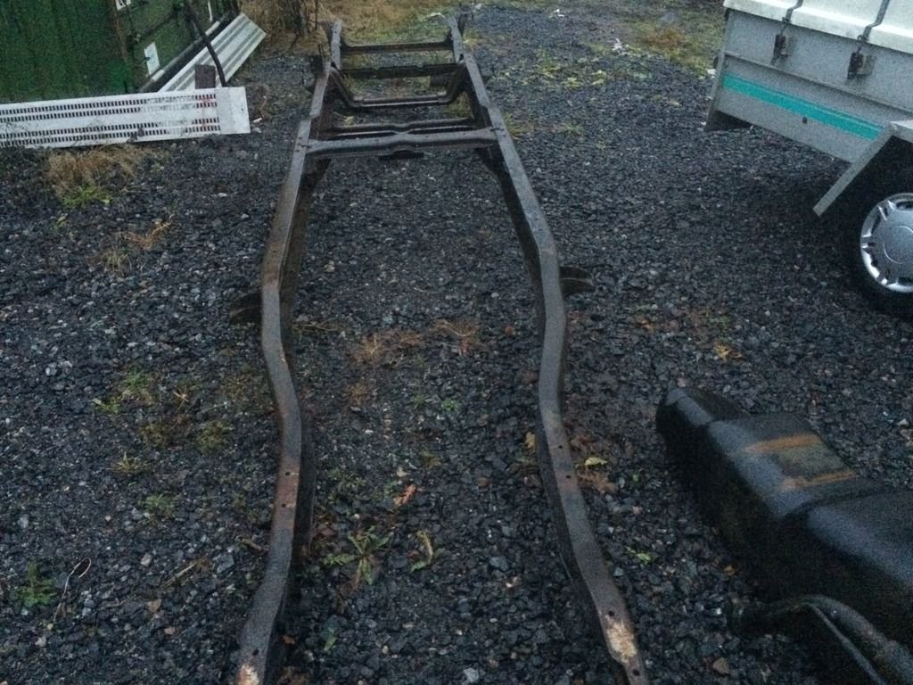

I haven't done much to the Crew in about week because we had our annual truck meet that I arranged and I have been building my other project. A Dodge Viper RT/10 1996. Just got it from paint shop and been assembling it. It's going to be a mean machine. In about few weeks it should be done.
Anyway my friend called that he would have some time now to lift the cab off.
I'm hoping to get the two front cross frame rails off first to get the front axle out.
After that it's sand blast time for the frame, cab floor and beds floor on both sides. I have about 3 weeks to do it. If I can't manage to do that I'll be back in October.
I'm going to do a 7 state/5500 mile road trip to the USA in September!
It would be awesome to meet and have a chat with some of you guys writing over here. I'll be visiting TX,OK,NM,AZ,UT,NV and CA.
You are very welcome to send me PM about my trip details if you want to meet me.
Oh yeah... And here's some pics of the current progress.

Old Aug 4, 2015 | 09:38 PM
Coming apart nicely! Nice clean looking frame though!

And back to the Crew cab.
I parted out the Crew Cabs frame.
Took out the axles.
Boy I hate those rivets!!
Rear axle removal was little tricky too... All 4 rear leaf springs were jammed. Well a little heat solved that problem... Bushings were on fire!
