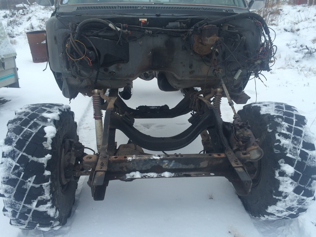

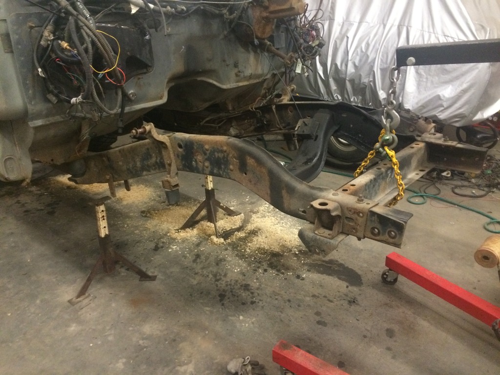

Starting to cut up the front so I can get the front crossmembers and drilling templates for the Crew Cabs frame.
But first removing that weighty front axle!
