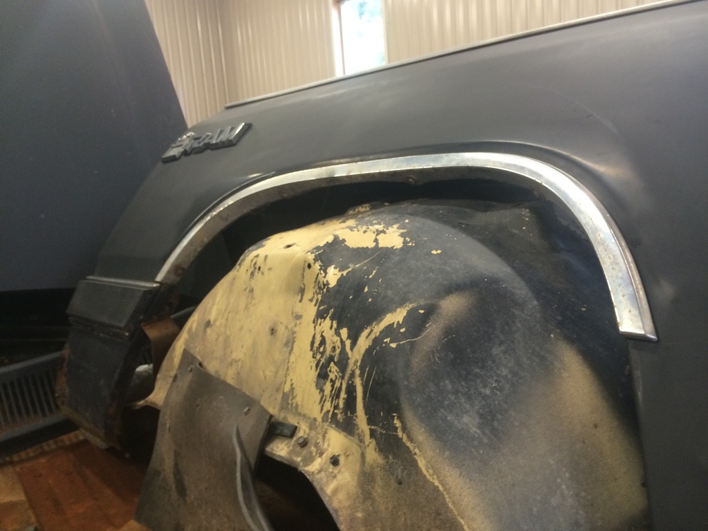

Anyway, I went to look at the truck and it was horrible. The body itself was pretty much rust free but the condition of the truck was bad... I didn't buy it because it was THAT bad.

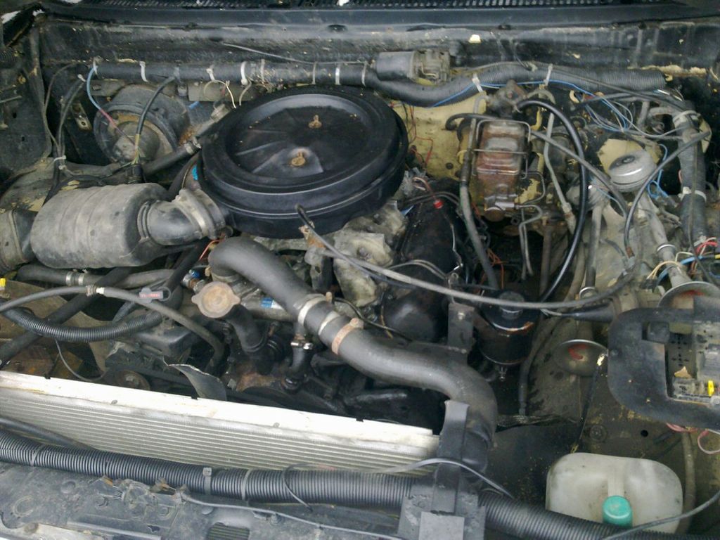

Basicly everything was wrong on the truck. Only gauge that worked was the gas gauge. And some markers lamps... Oh and the heater fan.
I bought the truck in late march and used it for a few days to haul 1.5 tons of concrete and some building blocks for my new terrace project.

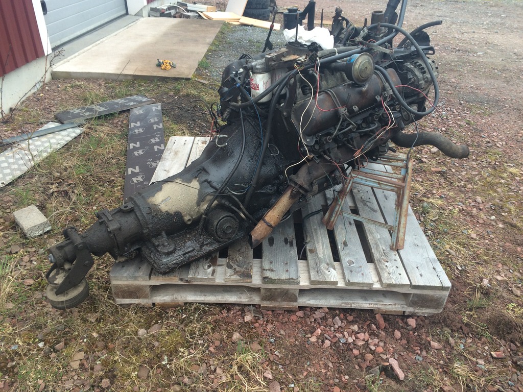

Somewhere in May I yanked the engine and tranny out of the truck because I managed to get a buyer for them. I got 1300euros out of them.
So my insanely rare crew cab in here costs only 1600 euros at the moment. For your knowledge, shipping from usa costs about 2500euros alone. And 34% tax in top of the trucks price and shipping.

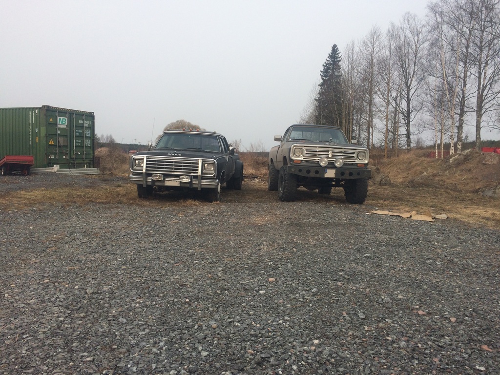

My plan is to take EVERYTHING from my 1990 W-250 to the crew. And I mean everything. Axles, whole wiring, dash, front doors,heaters, radiator support and hood. Frame, cab and bed stays, except I'm making it a SRW bed.

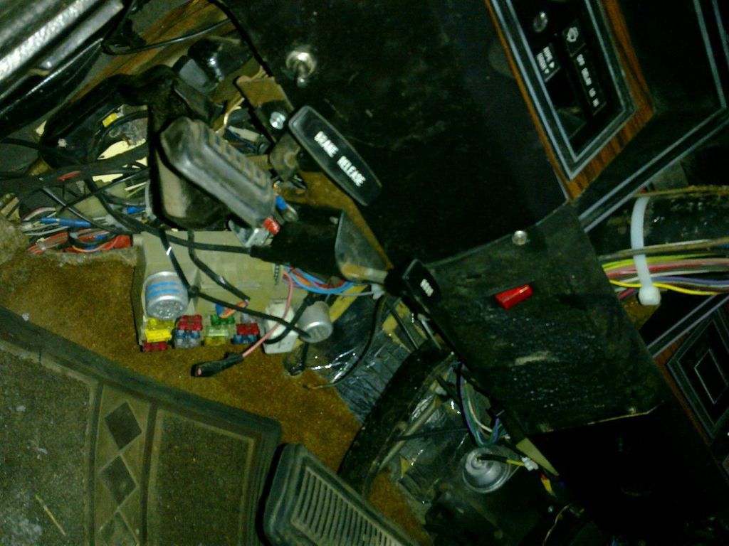

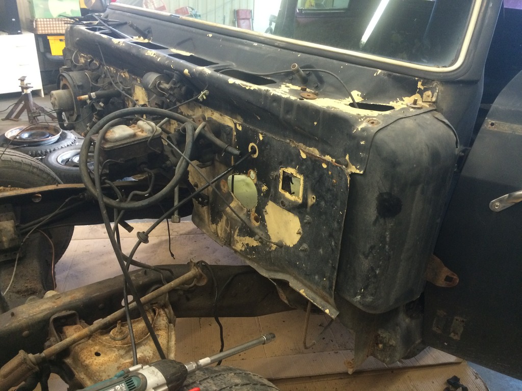

Everything is all messed up the crew. It even had and electrical fire somewhere near the fuse box in the past. And I had 4 years worth of time to fix all the electrical gremlins out of the W-250 and mechanical too.
Basically it's going to look like my reg cab, except with four doors. And it's going to be all black with some red stripes. I'm going to use 2nd gen Ram front and rear seats.

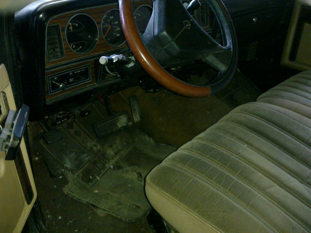

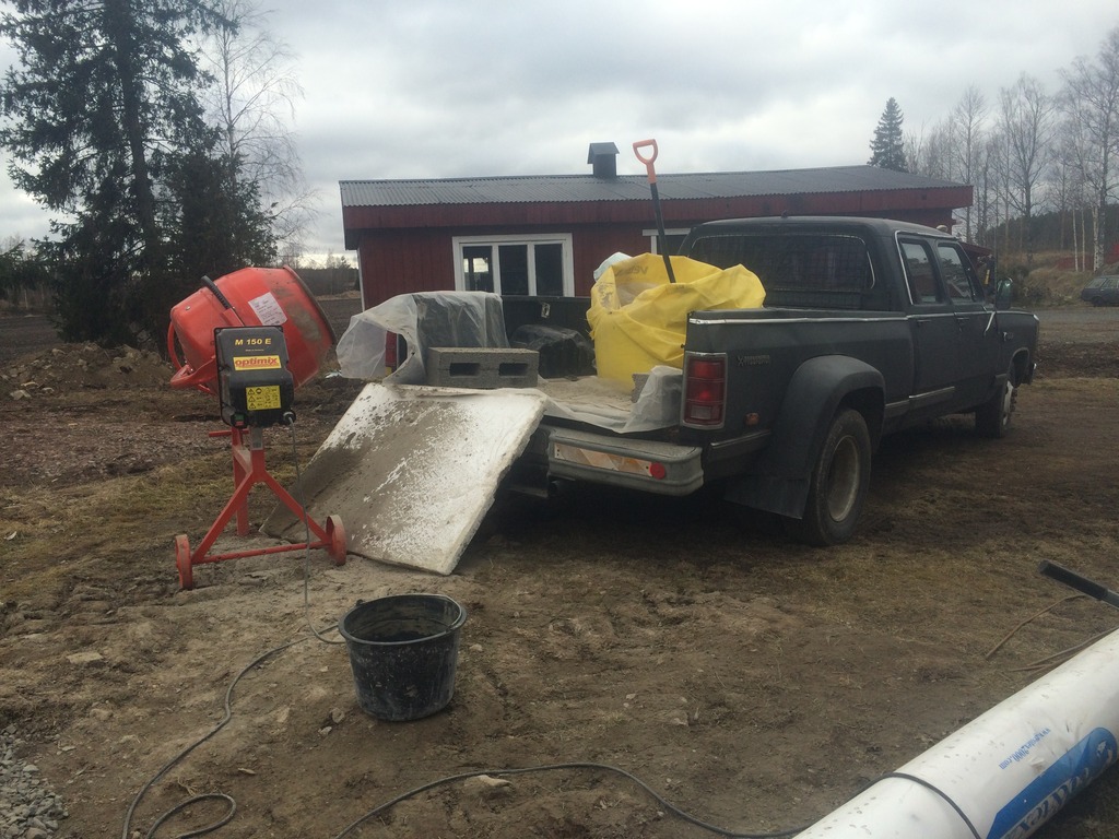

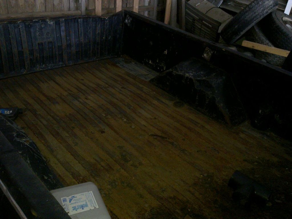

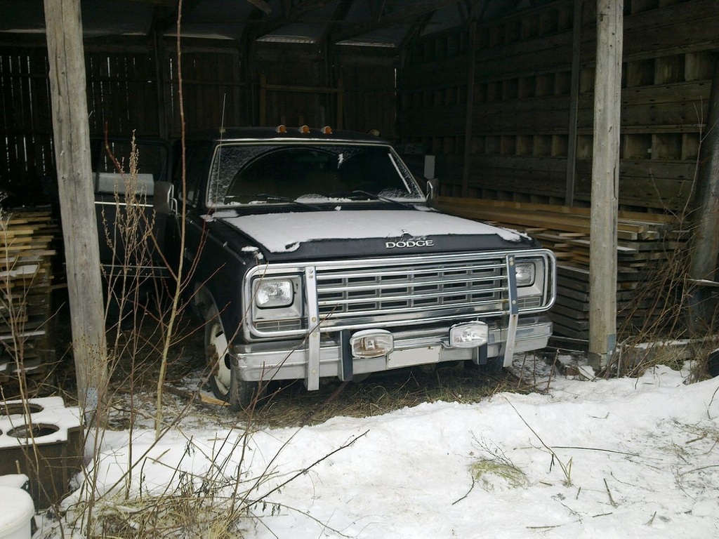

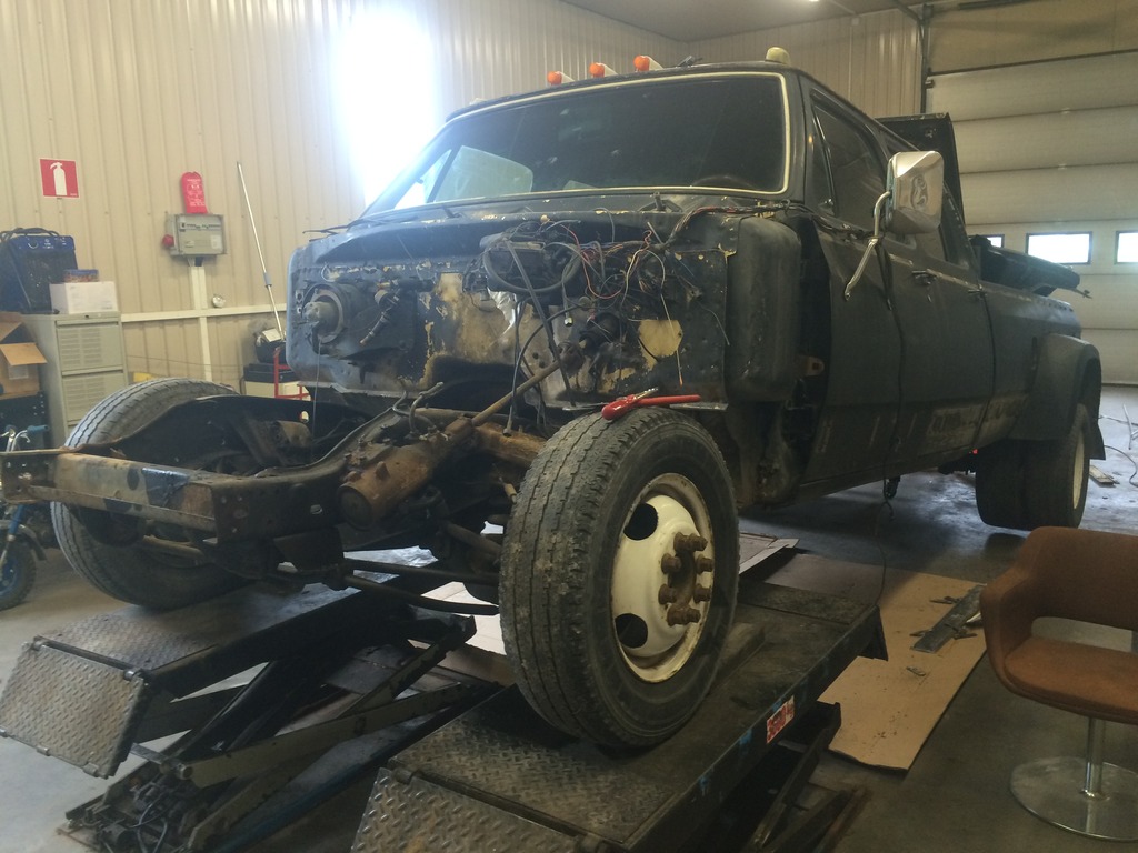

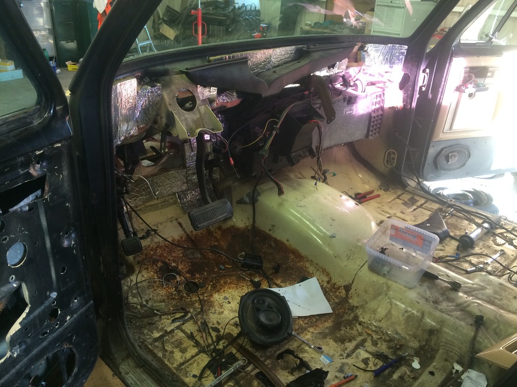

Here's some pictures:

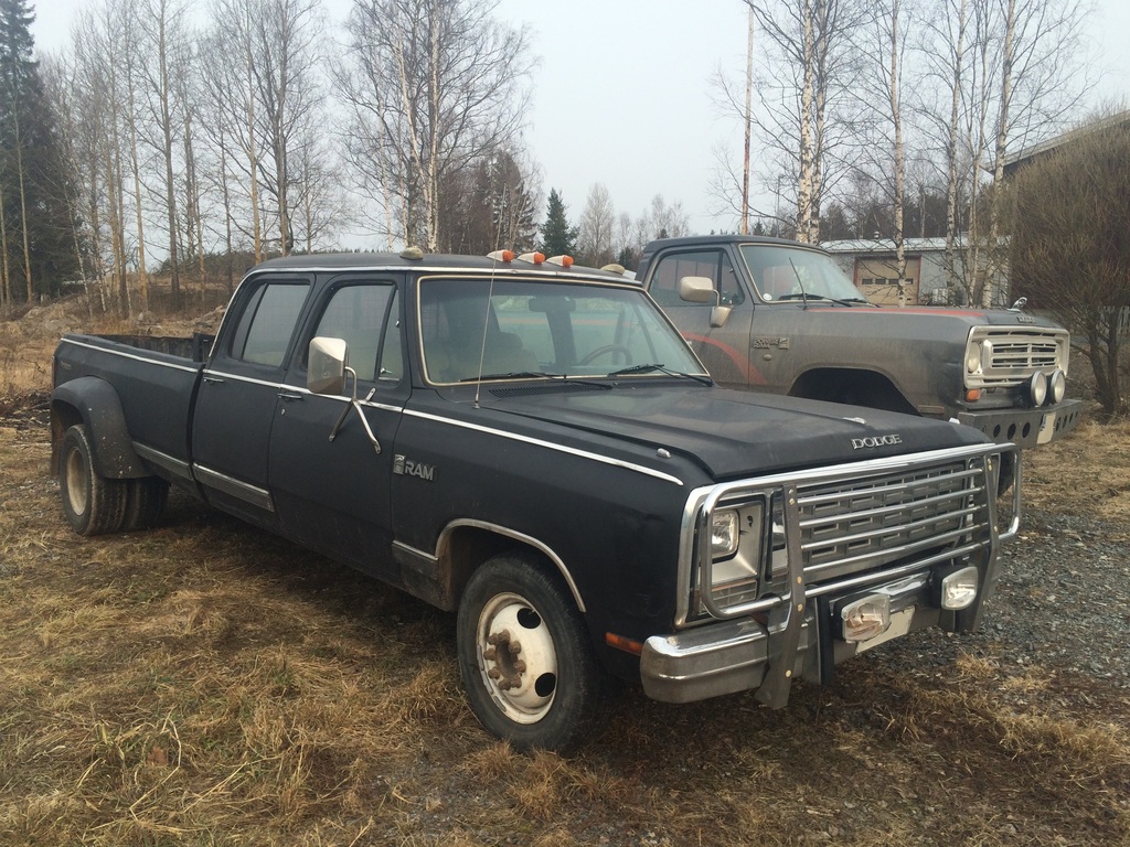

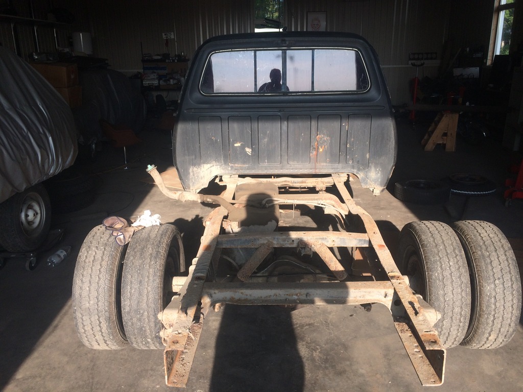

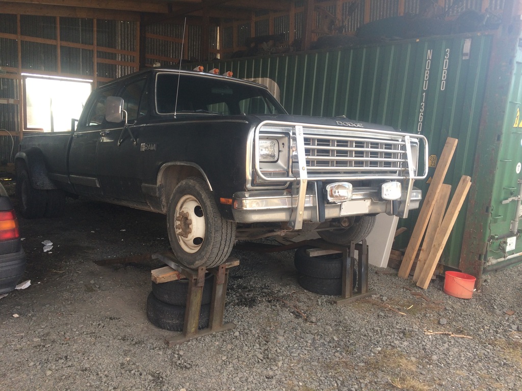

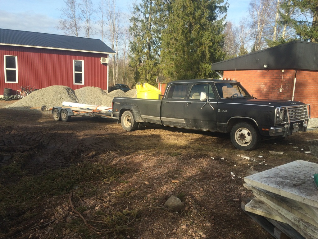

First time I saw it:

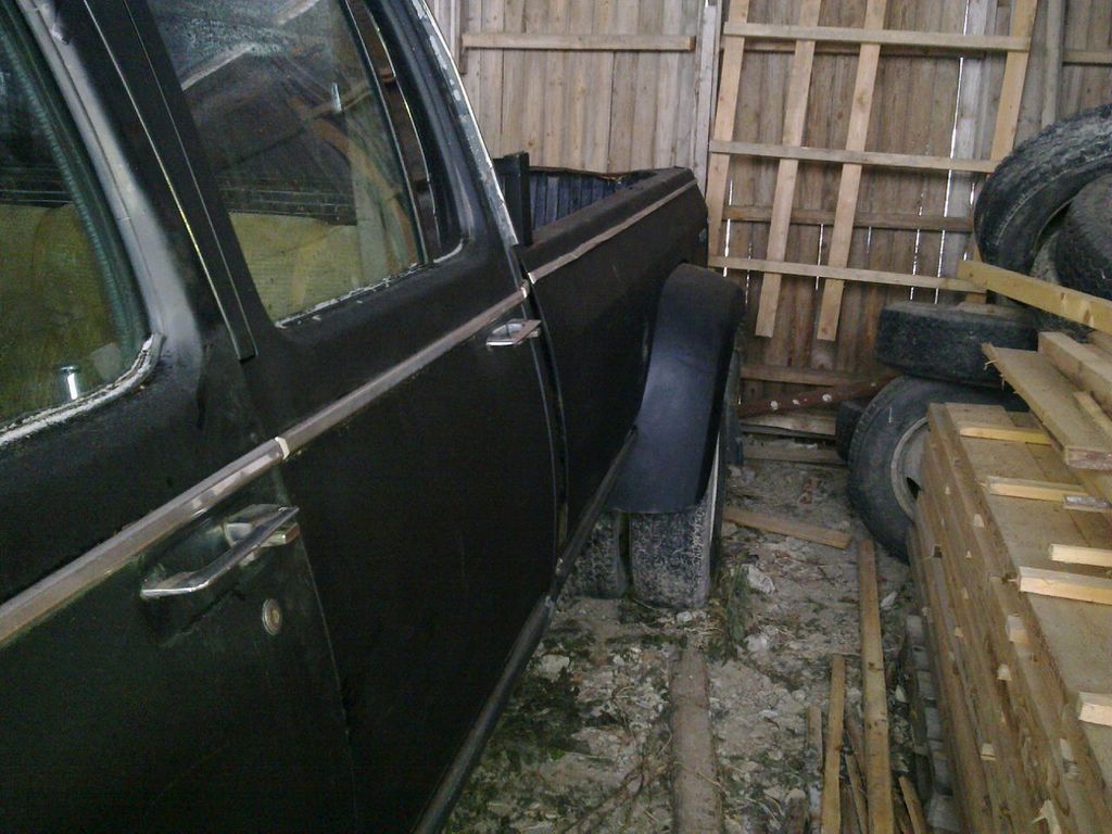

Sales ad pic:

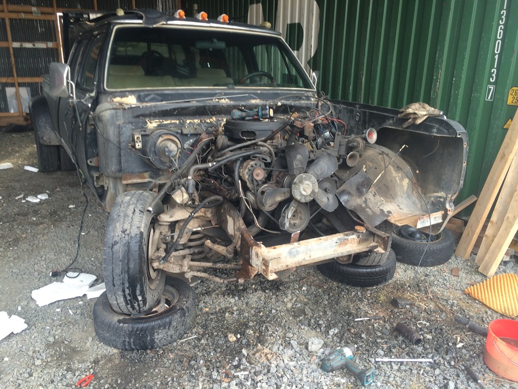

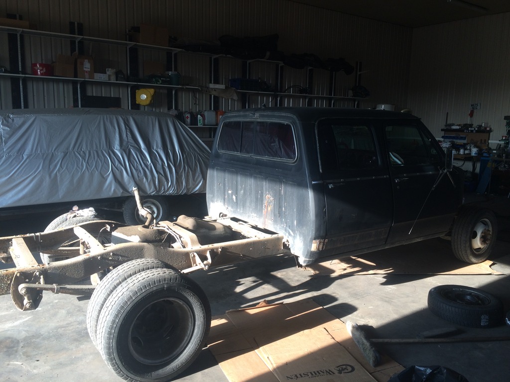

Reality:
And more to come when I'll have time to upload the pics!

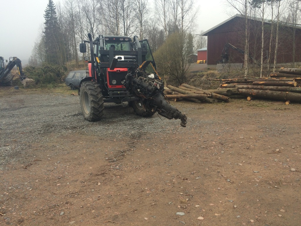

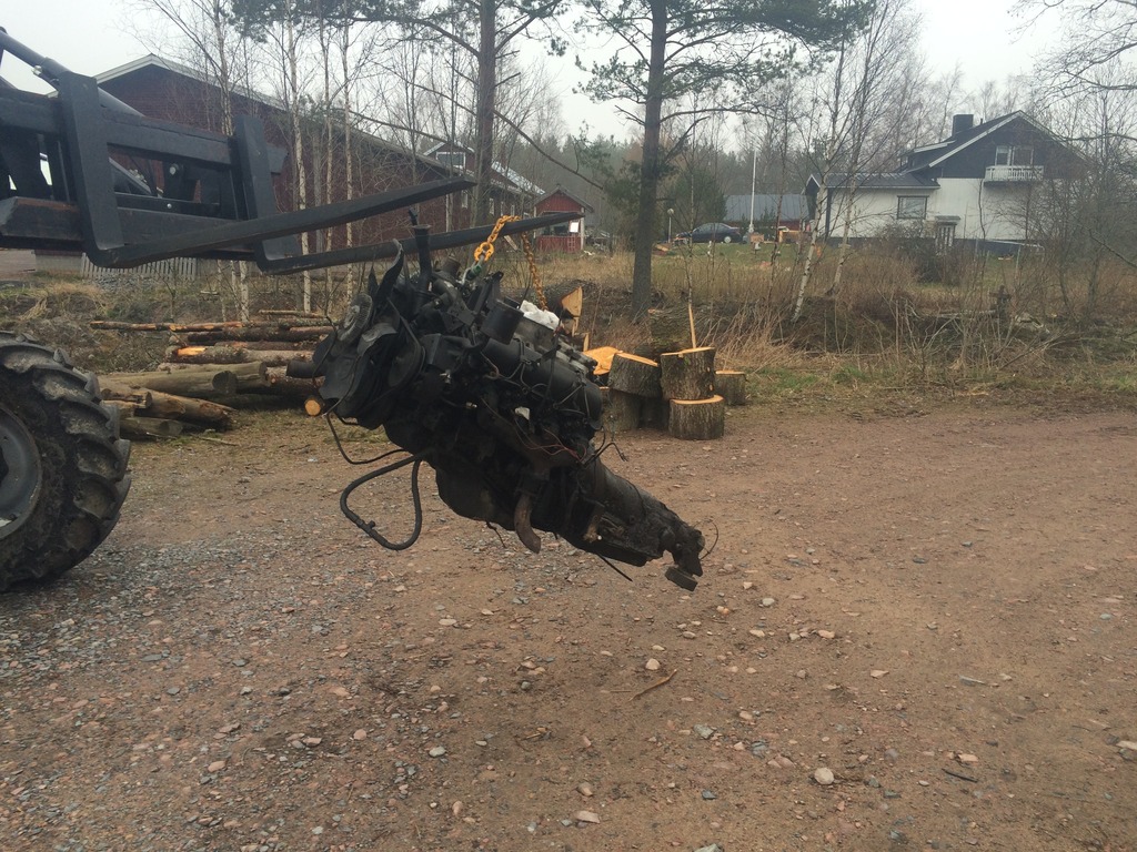

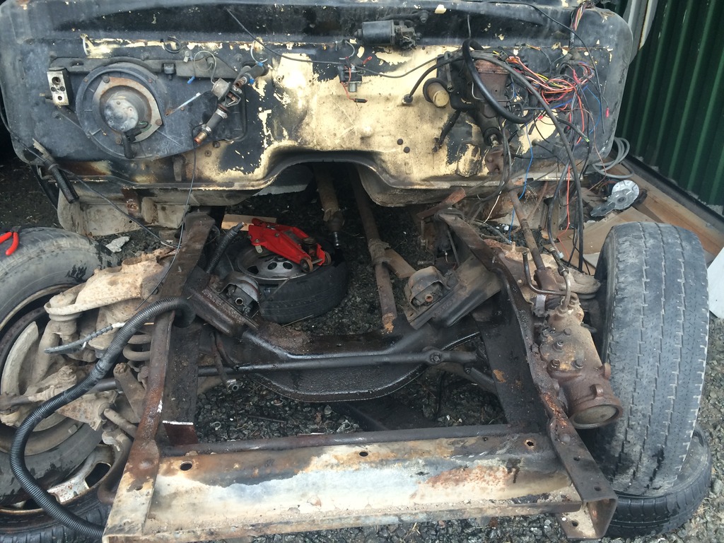

.My plan is to take EVERYTHING from my 1990 W-250 to the crew. And I mean everything. Axles, whole wiring, dash, front doors,heaters, radiator support and hood. Frame, cab and bed stays, except I'm making it a SRW bed.

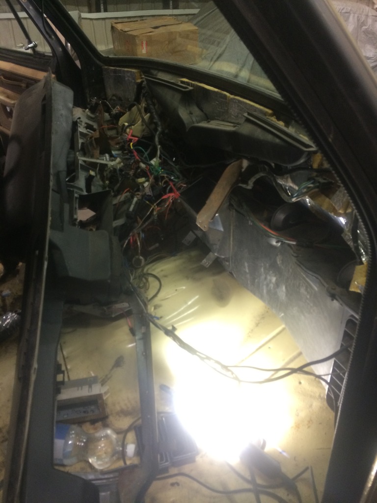

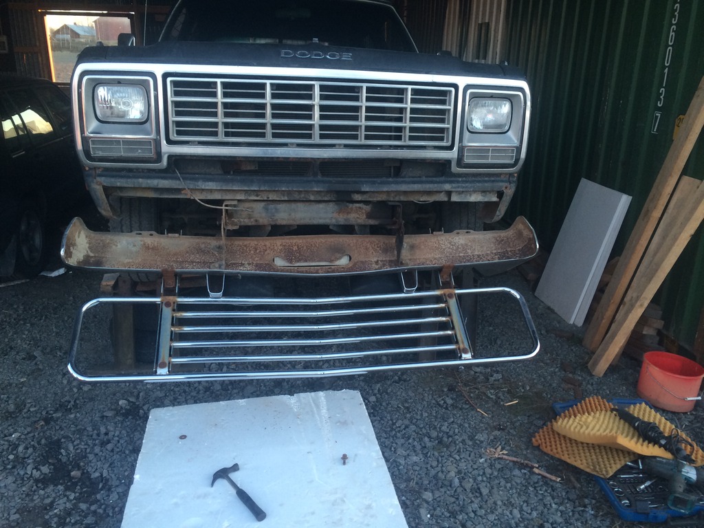

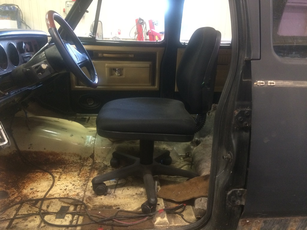

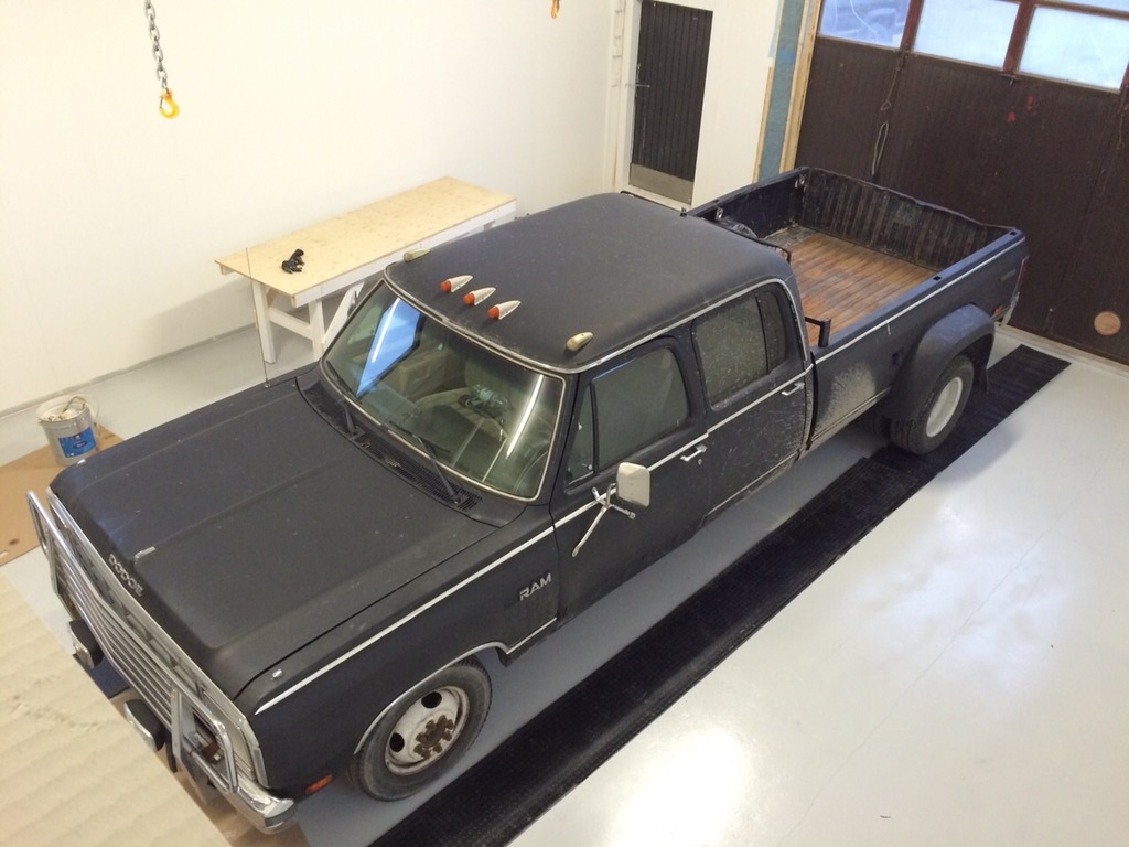

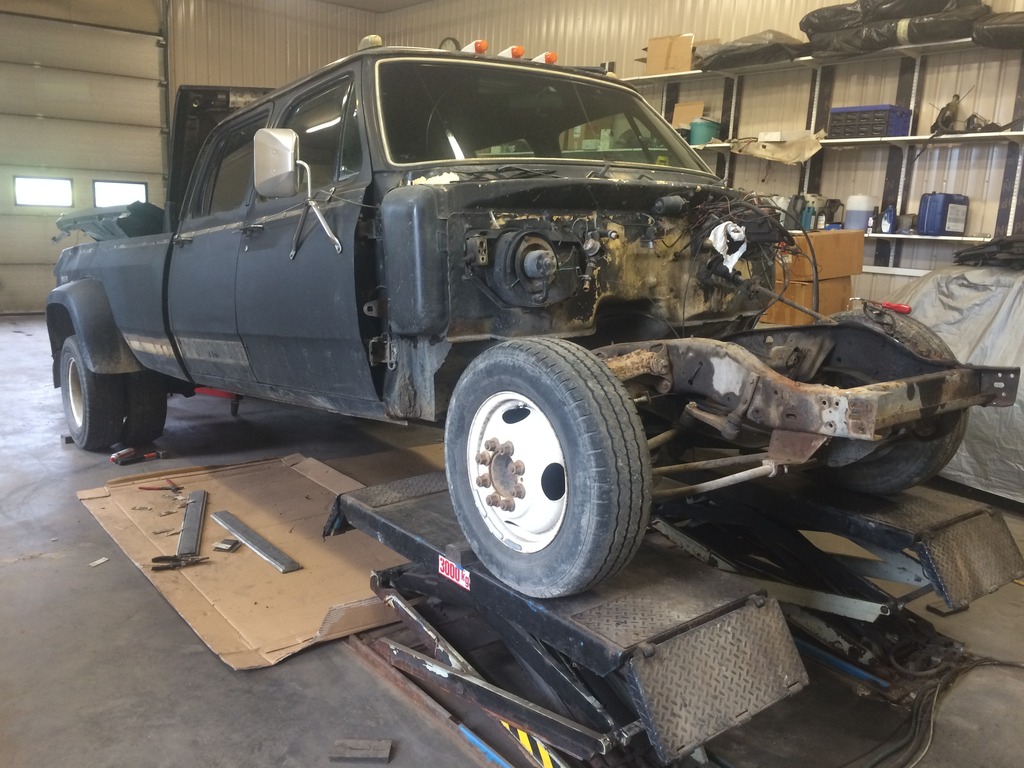

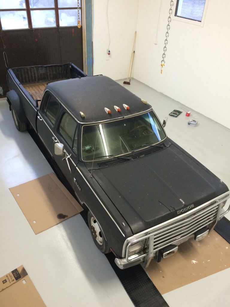

Sales ad pic:
Reality:

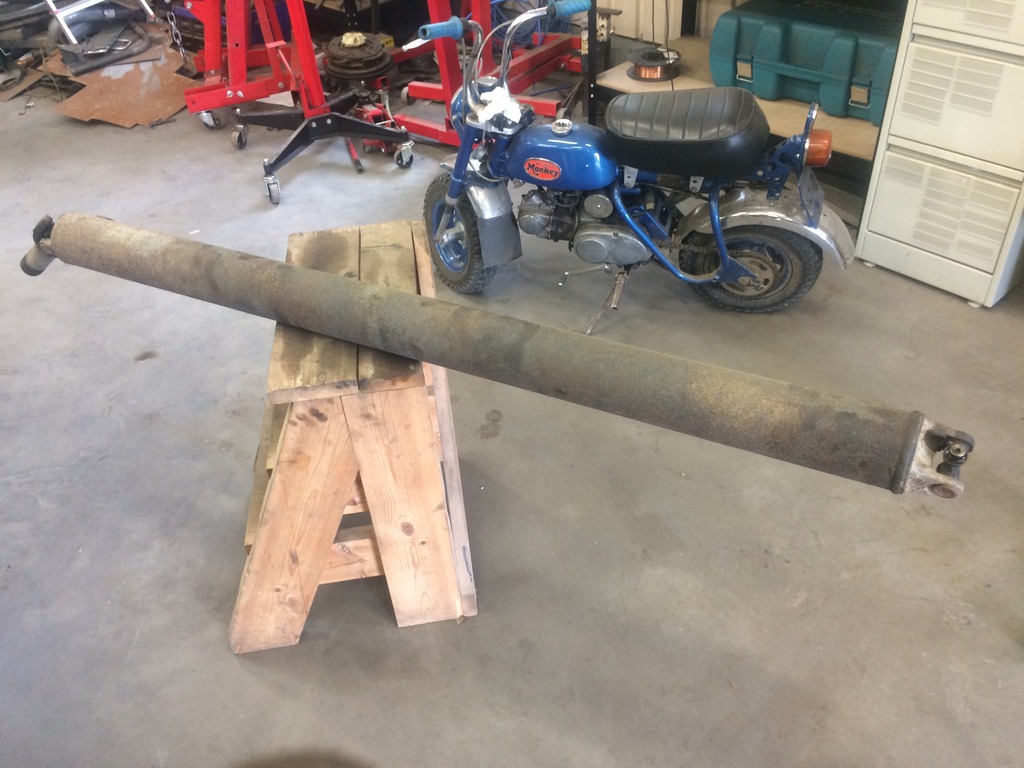

And the second question. My 1990 W-250 has single piece rear driveshaft with 1410 U-joints but my Crew D-350 has a two piece with center bearing and 1310 U-joints!? I thought they used 1410 U-joints.
What should I do with my build? I guess adding 30+ inches to the single piece is not an option...
Here's the rear piece of the rear driveshaft.

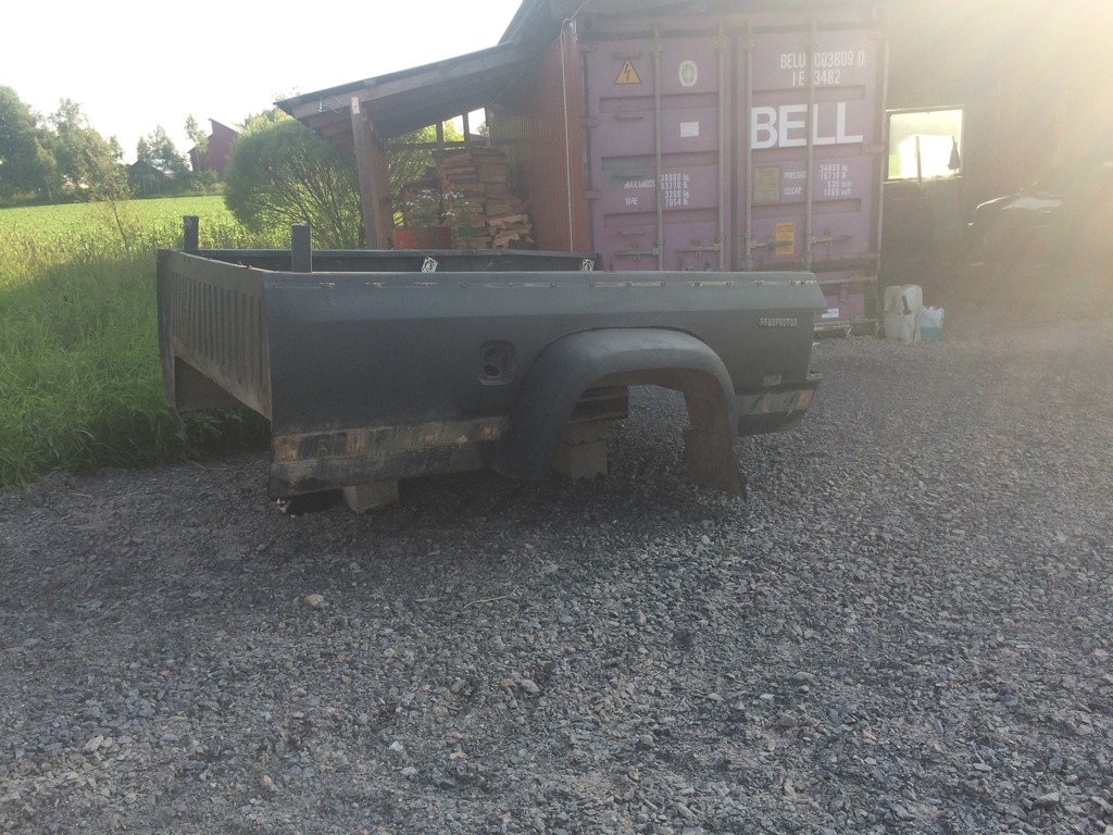

But I already have new bedside panels for SRW bed.
I like SRW's more to drive in here. Everything is so narrow in here and I occasionally go to the trails too.
And beside that dually axle has open differential too.
I'm going to swap the rear axle and leaf springs too.

The rear two piece driveshaft with the smaller U-joints is what you get on the W-350 Crew cabs.
I have used '92-'93 Ex Cab long bed Cummins 2 piece driveshafts to replace my crew cabs lighter duty gasser D-shaft out, several times.
It work really slick as the wheelbase is the same.
Just swap out the yokes on the NP-205 and the Dana rear axle [unless you are using a Cummins rear axle with the bigger yoke already].
Do NOT make a massively long one piece D-shaft, it will whip around do to its length at speed.

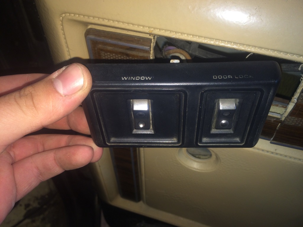

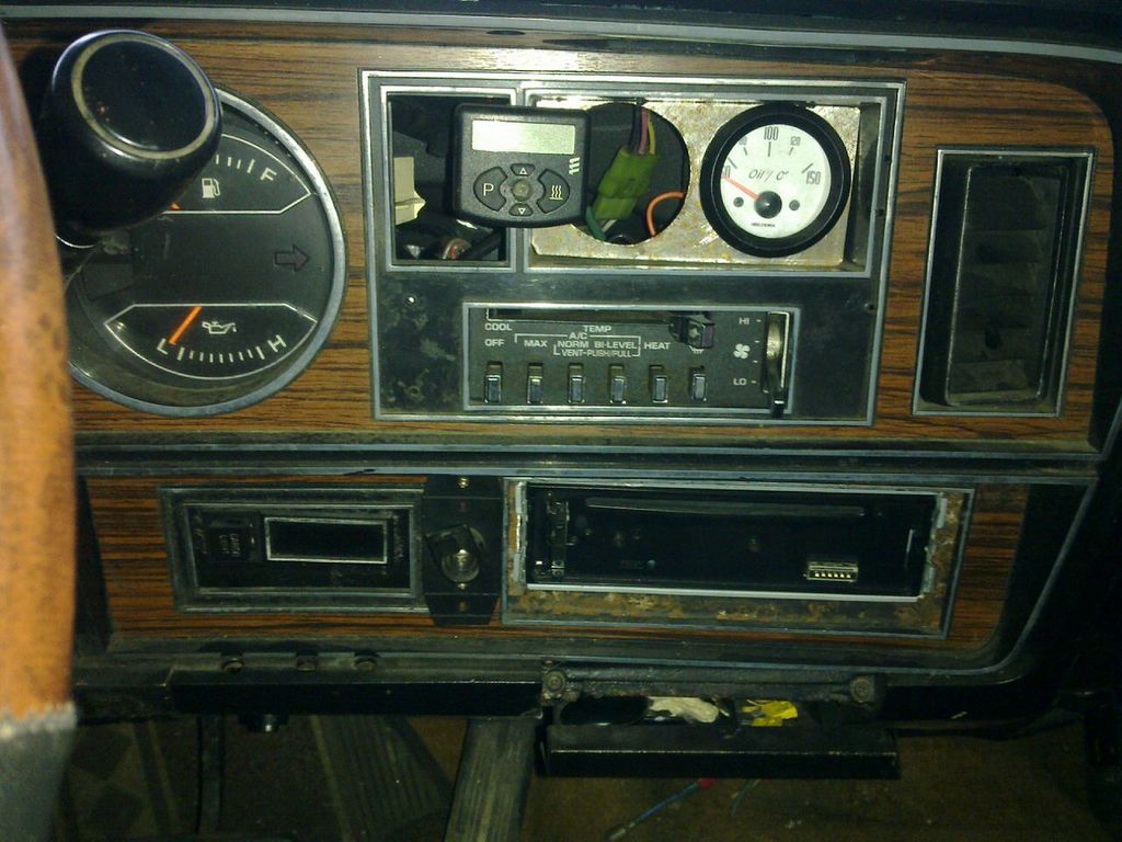

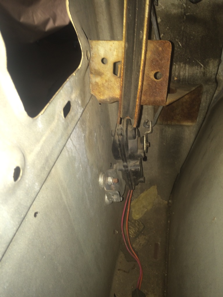

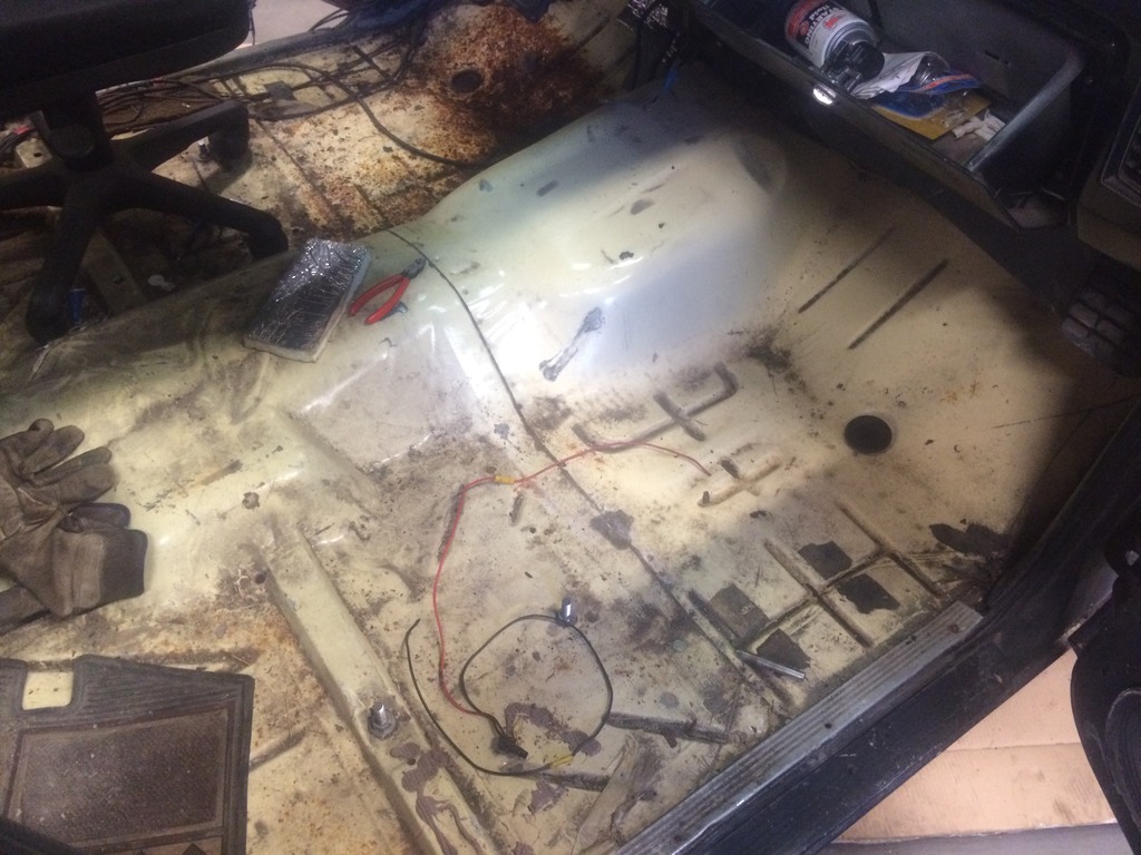

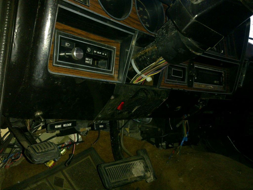

I'm starting to think that the power windows and power locks are someones poorly installed addition to this truck.
Here's a pic of the door lock motor inside the drivers door.
And the switch.

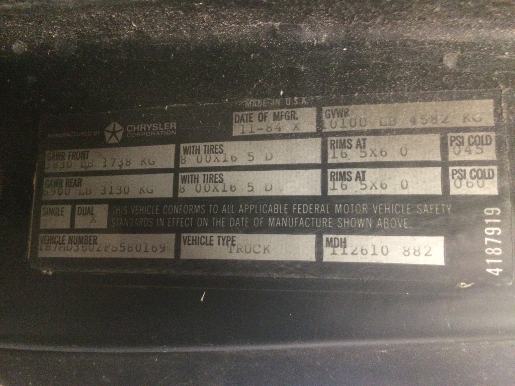

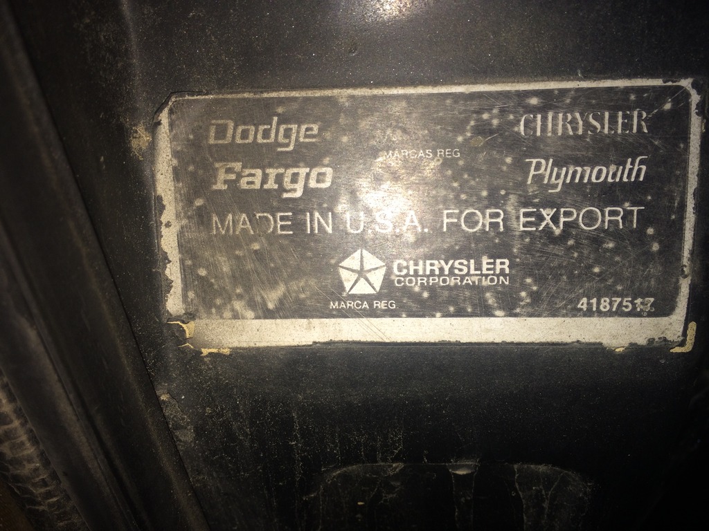

But have you seen this sticker before on the crew cabs C post?
And here's the ID sticker.
Is there something special/different to your domestic versions? Like weights?
And the switch.
