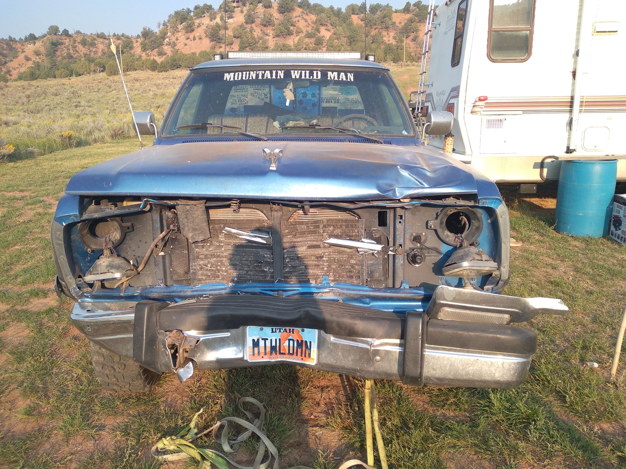

I ran into a large animal on my way to our property and smashed in the front of my 92. I am wondering if I can use parts from gas trucks, 91 to 93 guessing. Basically will need everything in front of the cab.

Some of the parts from a gasser will work. Things like the bumper, the fenders, the chromed plastic grille and the hood.
Things like the core support, radiator, fan shroud, fan hub, A/C condenser, intercooler will be 91.5-'93 diesel part only.
BTW, I will have ALL, or just some, of the parts needed to fix this truck in VT.

Cool I will get with you for prices when I get it tore apart so I know better what I will need. Thinking about getting a bigger inner cooler, and radiator since I gotta replace then anyway.
Old Sep 17, 2021 | 03:54 PM
You don't need to go with a bigger radiator, the stock unit cools just fine.
As for a bigger intercooler you have really only have a couple options, the all aluminum power stroke and a 2nd Gen cummins units. On the 91.5-93 trucks the PS unit works best, the 89-90 Non-IC trucks seem to work better with the 2nd Gen unit. I have the PS unit on my crewcab and it was a bit of work and a tight fit....you can check out my install in my build thread.
