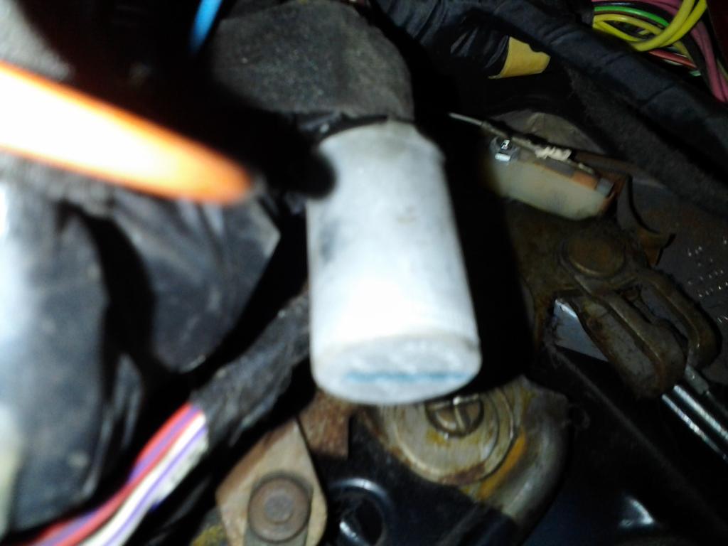

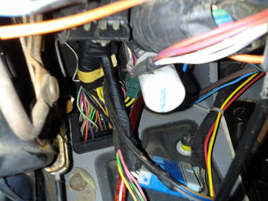

Hello I have a part under the dash that stays warm to hot all the time even when I haven't started or driven the truck does anybody know what it is or what it does? It is about 1 1/2 inches long maybe 3/4 inch diameter aluminum
cylinder in the picture. A little left of the steering column. Kinda worried about a fire it gets so hot sometimes.

Looks like the power box for the halo light for the ignition housing to me. They do get very hot.
Old Jul 3, 2012 | 12:24 AM
Yup that's a timer for a courtesy light..ignition, door lamps etc. As Flatbed stated they generate heat and then convert that back into electricity for a few seconds to power a light or two.

Ok thanks for the info I was wondering since it was always hot I thought something was wrong. I don't want my truck to catch on fire.

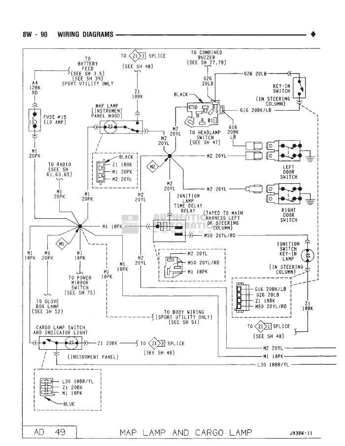

Right in the middle of the page. Runs the key in lamp.

Couldn't I eliminate the one in my truck then since I don't have the key-in or halo ring lamp? According to the above schematic, I don't see any other reason for it to be there.

Unplug it and see if it breaks anything.
