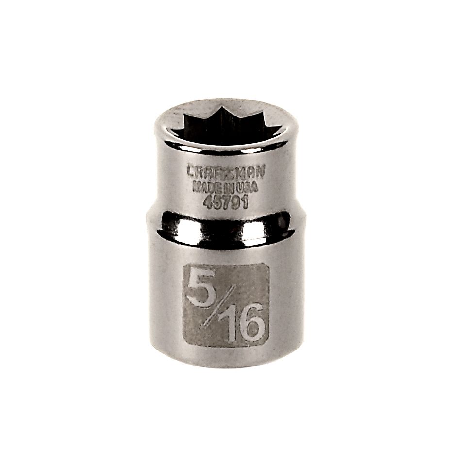

Any ideas on where to get one of these square drive sockets? I don't trust my calibrated arm that much .

I know Sears carries them, along with any of the main tool vendors (Snap-On, MACS, etc). They seem to be more of an automotive-type tool, so I doubt if Home Depot or Lowe's would have them...but if that is all you have in your area it might be worth checking.

This is what you're looking for (not sure if 5/16" is the right size, though...) - it's called an "eight point socket."
