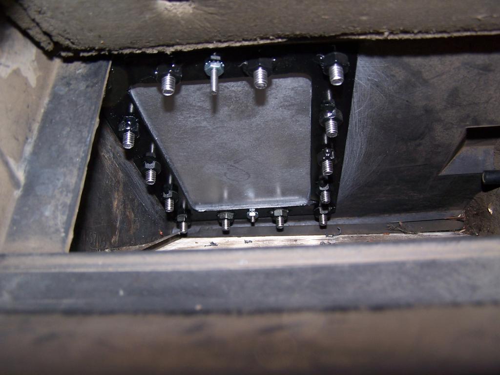

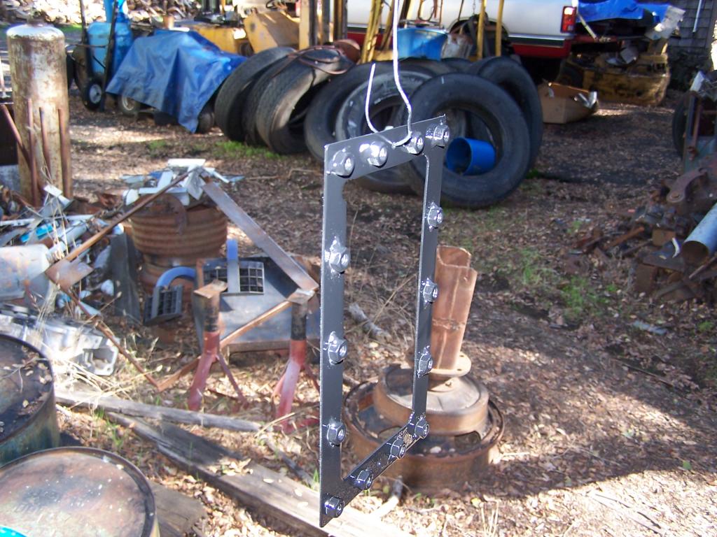

Today something stuck. I got the hole cut and made a backing plate with 1/4-20 nuts welded to it. This it what I have so far.
Attached Thumbnails 1990 D250 to W250-100_5325.jpg   1990 D250 to W250-100_5327.jpg   1990 D250 to W250-100_5328.jpg

I like the button head bolts...but the geometry of the holes is making my eye twitch.
Maybe it will look better when the cover is sanded to shape? The end Holes wouldn't work in the center of the plate because that is where the backer retaining bolts go. (could be some distortion in the picture too). For some reason it looks different in the picture than in person
Check in later and see if it looks better after I square up the plate and get it all fitted up.

LOL, I don't think that will do it. It does the same thing to me, the problem is with the size of the part, you have a different bolt spacing along the length than you do the width....... Most folks just accept it as normal, but some of us super OCD types like symmetry.
The only way to fix that is to make the width taller to get the bolt spacing correct........
BTW, don't do that, a coat of flat black and a wooden mallet hung where you can whack whoever looks under there will suffice.

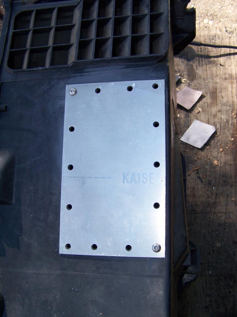

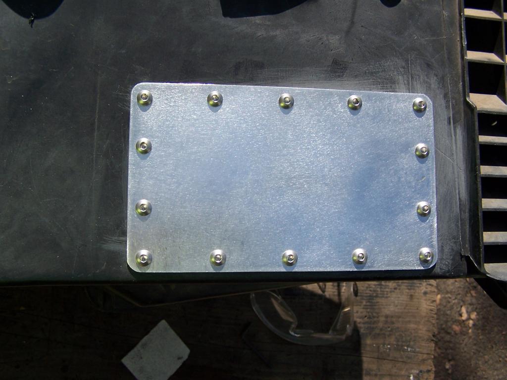

Well I finished up my asymmetrical holed part today. I could use some shorter screws though.
