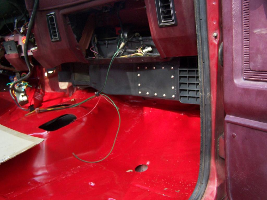

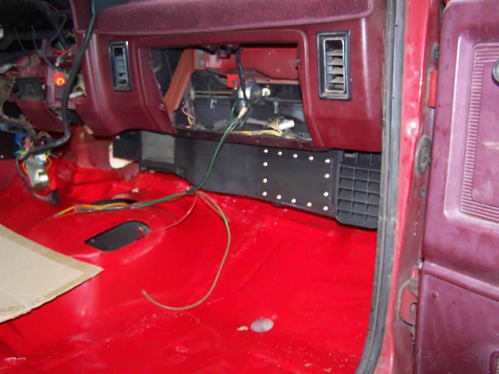

Is it me or is there something seriously wrong here?
Something actually got put together! What went wrong?

Originally Posted by NJTman
That floor is just way too pretty.....
The more I look at it the more I like the color.
The part that didn't show up in the pictures is the front of the HVAC is painted hammered black.

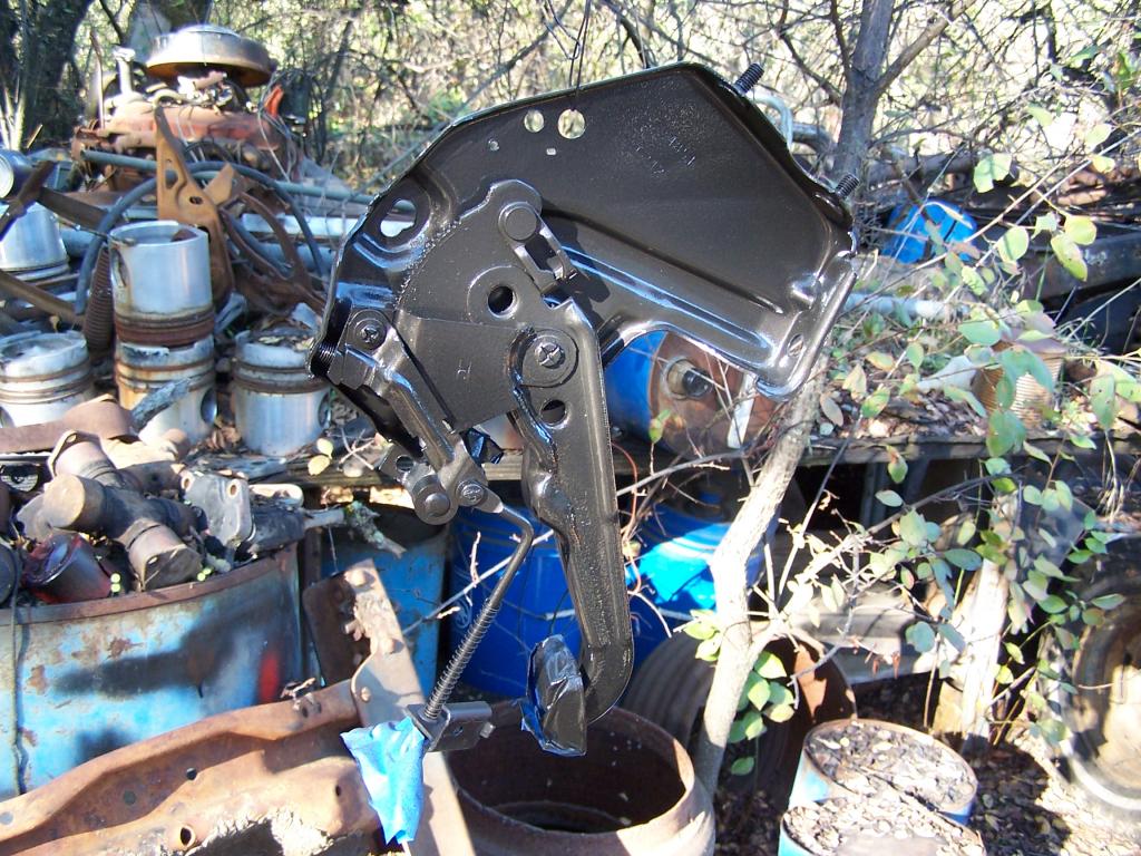

I made some headway today. You may notice the addition to the message center. I also cleaned up the steering column some. At least the metal part. The plan is to paint it hammered black to match the pedals and HVAC box It is going in the right direction at this point

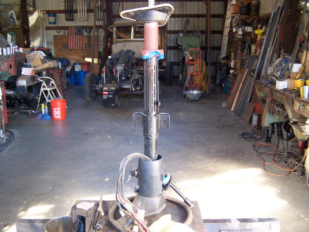

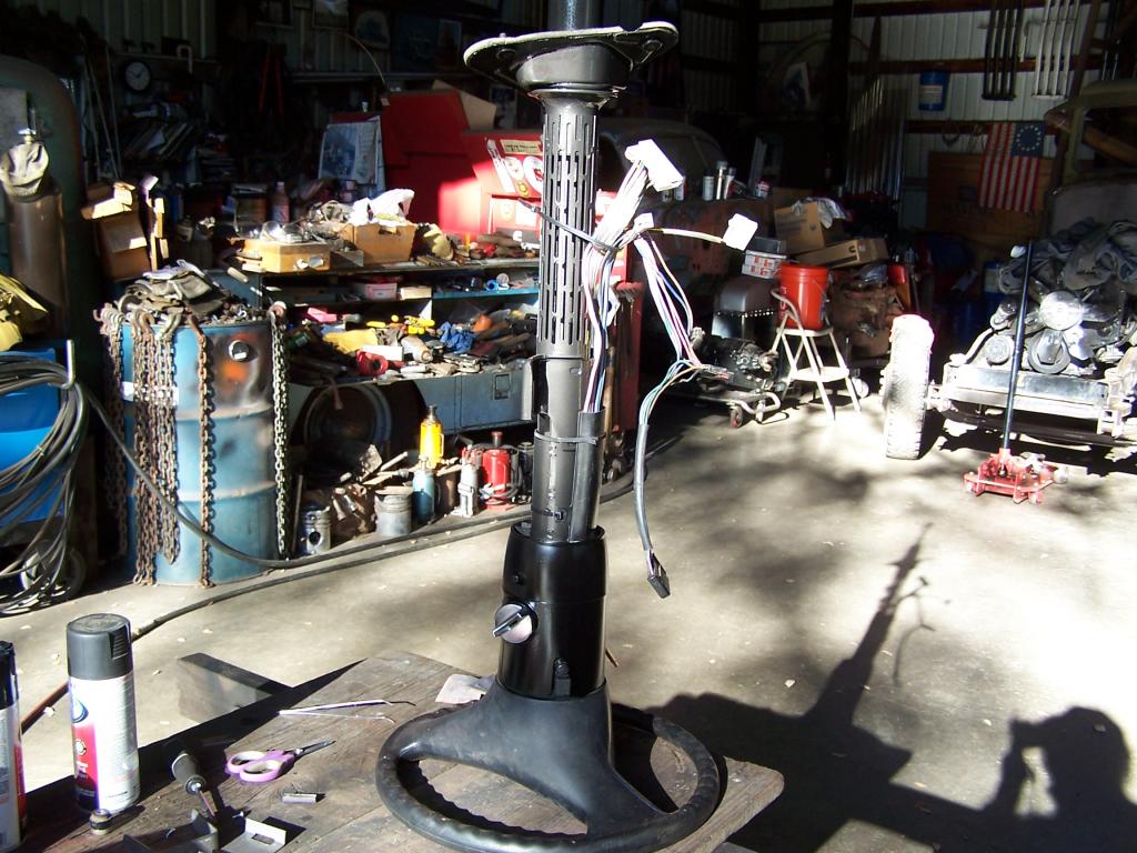

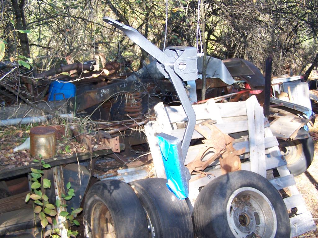

Got a wee bit more done last week.

I got the steering column together and in. I also did a check on my reworked transmission wiring harness. all works so I can put the pedals in and tie up the wiring. I'll take some pictures tomorrow.
