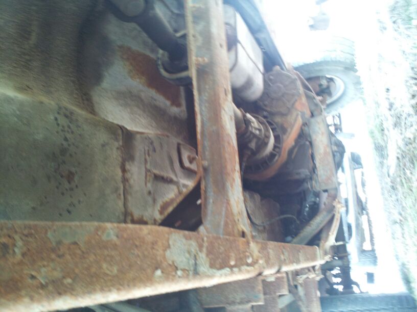

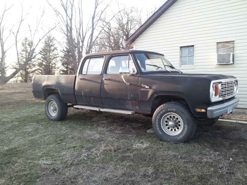

Hey Guys recently picked up a 78 Crew cab w200 Ex Firefighter truck. 400BB starts and runs like a new truck with 4 speed in it. Tranny Shifts great, has 5th wheel hitch, trailer brake, class V receiver. Previous owner used it as his tow rig. Put it on hoist at shop, everything solid underneath. Definitely worth $1500 bucks.
Here's some pictures of the beast..
