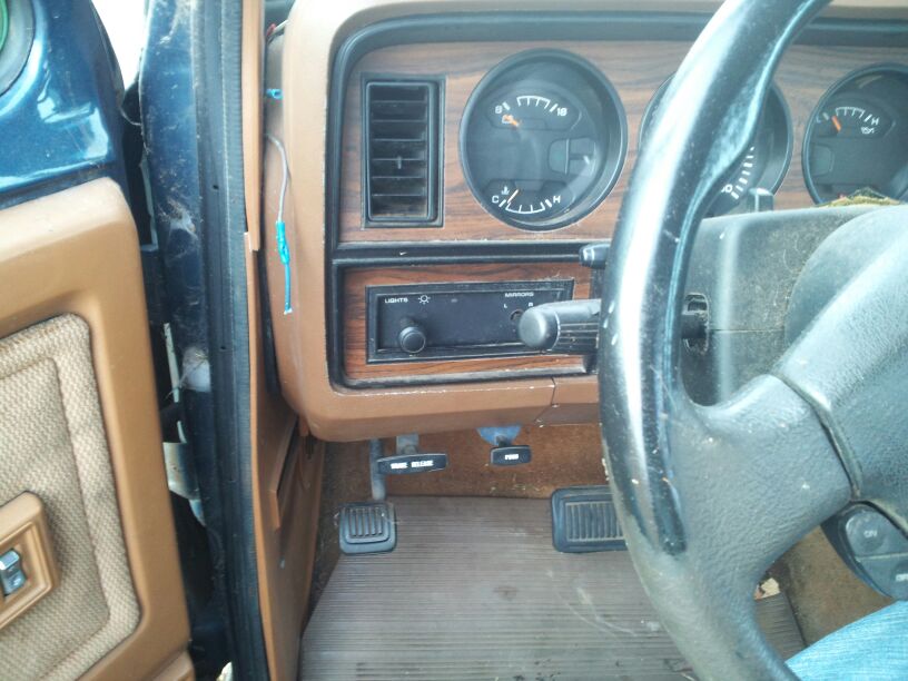

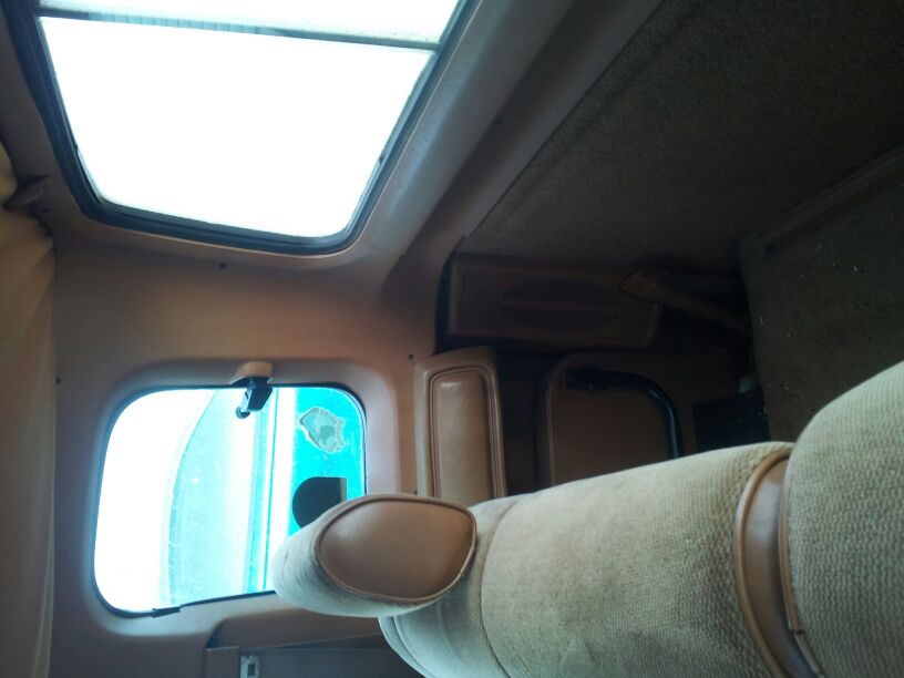

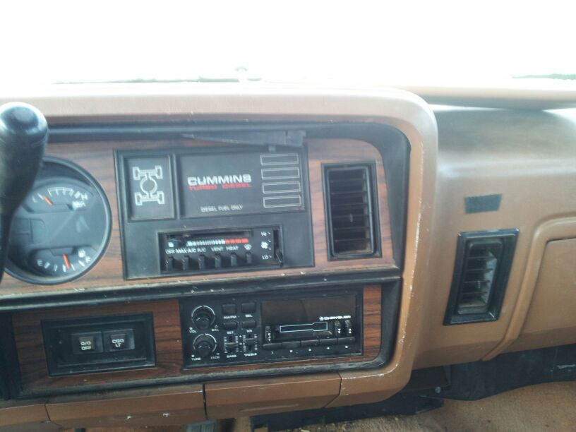

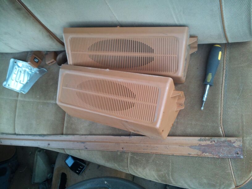

Been a while since I been on here, just been searching for a good Donor truck, and actually got a front clip with interior minus the frame,axle, and drivetrain since I won't be using any of that. Its a 92 LE which I found extra few goodies in the glovebox since it was a 1 owner truck. Heres some pictures to follow---Now I can start dismantling cabs and modify firewall, start building a solid foundation for the cab to ride on.
Old Mar 9, 2014 | 08:10 PM
  #52
Lenny Boysen's Avatar
Joined: Mar 2013
Posts: 41
Figured out how to post pics...Just need to get the driver kick panel and headliner front trim piece and find a parts 80-85 truck for the center post between doors for trim pieces(Did they even make em?)
Attached Thumbnails 1978 Dodge Crew cab to be built!-2014-03-09-17.38.09.jpg   1978 Dodge Crew cab to be built!-2014-03-09-17.40.21.jpg   1978 Dodge Crew cab to be built!-2014-03-09-17.40.37.jpg   1978 Dodge Crew cab to be built!-2014-03-09-17.54.37.jpg   1978 Dodge Crew cab to be built!-2014-03-09-17.54.47.jpg

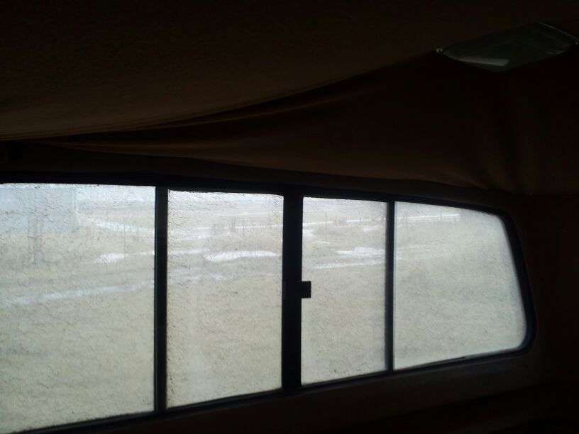

More images---Even found Original build sheet in the glovebox--wasn't expecting that along with owner's manual..
Attached Thumbnails 1978 Dodge Crew cab to be built!-2014-03-09-17.55.02.jpg   1978 Dodge Crew cab to be built!-2014-03-09-17.55.43.jpg   1978 Dodge Crew cab to be built!-2014-03-09-17.56.02.jpg   1978 Dodge Crew cab to be built!-2014-03-09-18.27.45.jpg   1978 Dodge Crew cab to be built!-2014-03-09-18.41.42.jpg
