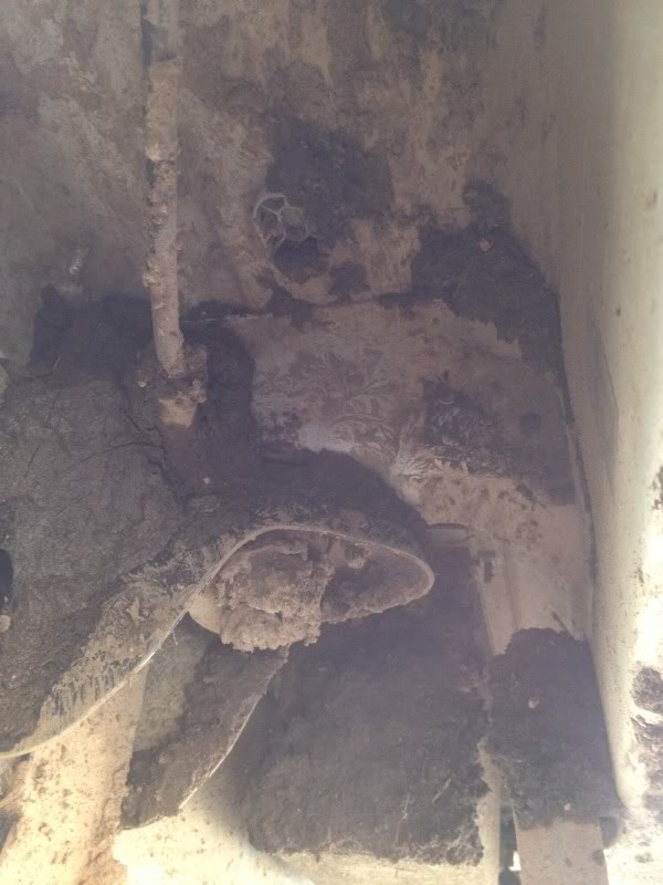

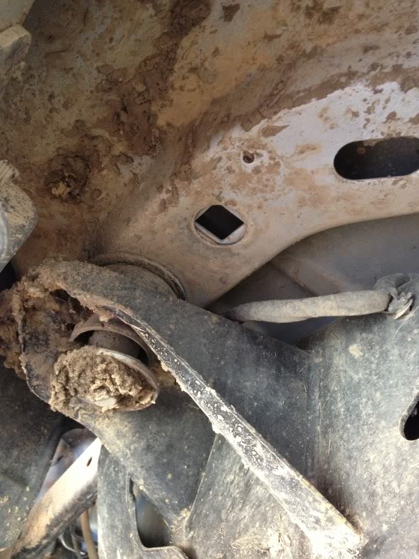

I believe they are

Thanks man!, certainly does look like its part of the floors. I saw mini photos on my phone at work and got to thinking hell yea, in floor storage on a 78 just like the 2010...Shall be sweet!!
