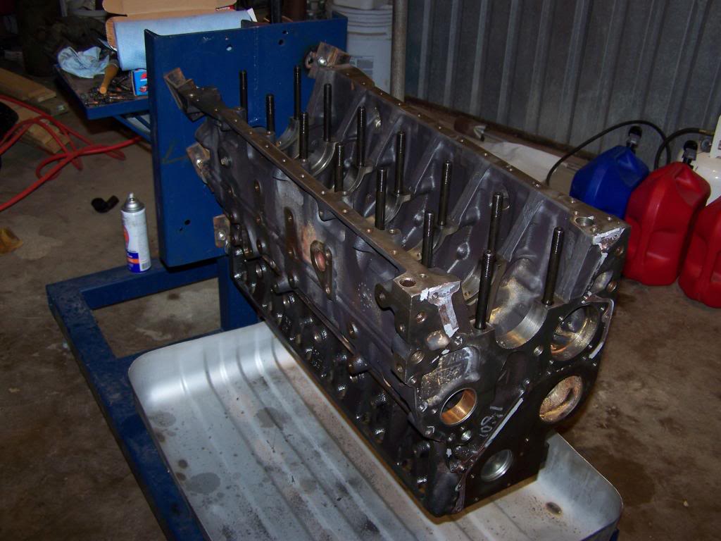

finaly going back together. I will hate to see it and the truck go

Thats a beautiful sight. Are those 14mm main studs?

yes they are

That's a nice stand, and also a sharp looking block in there.
For those planning to purchase or build a stand for this engine; I would say, regardless if it's 900, 975, 1100, or even 1250 lbs, you should plan on a 5X safety factor. So it's probably safe to purchase a 5000 lb max capacity stand. Any less than this probably needs to have a built in safety factor, recall that this weight rating is for a static load, things change rpaidly when that load becomes dynamic. And that's the reason for a safety factor.
