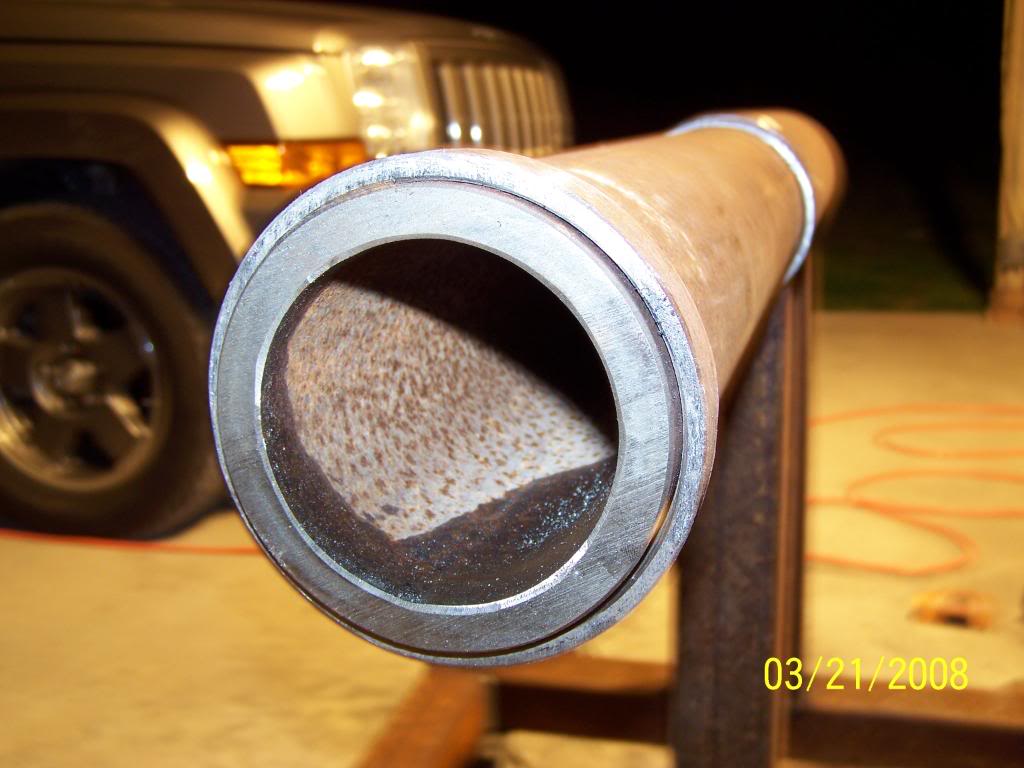

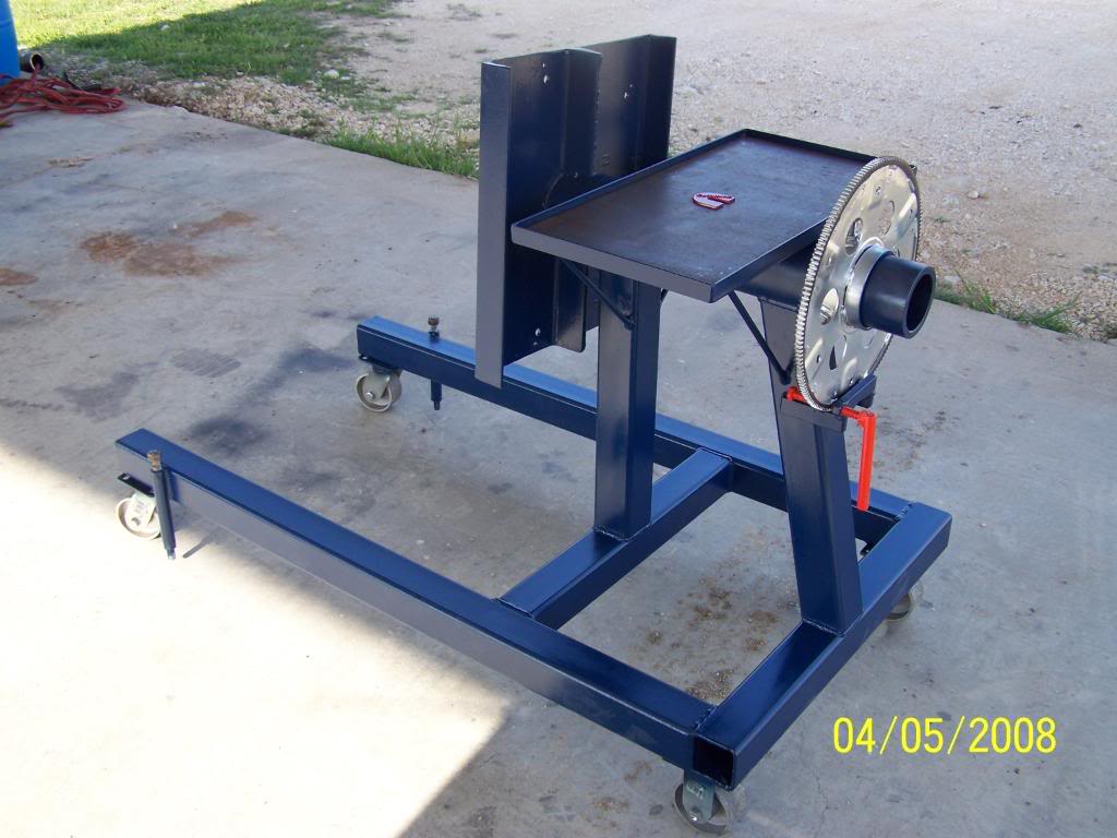

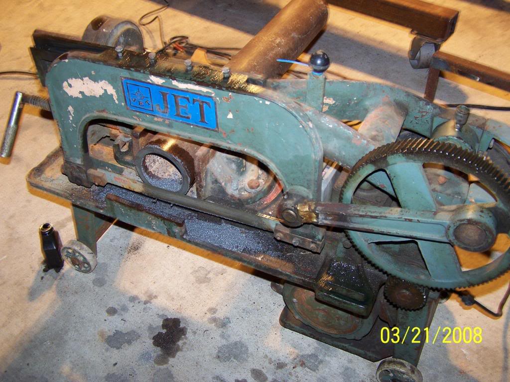

this is the second one I have built and they work great. I called Southern Plains Cummins and they said this is how they mount the B.
3" X 3" X 3/8" square and 5"x 3/8" pipe out side and 1/2" wall pipe center and 2 12" channel iron welded side by side for mounting plate. will hardly budge and roles with one hand with engine mounted ( but takes 2 hands to stop that heavy thing)
1/4 turn of the orange lever and is fully locked and can not turn. Plan to use a starter gear to turn but I tore a 5.9 down a few nights ago and just turned it over by hand.
older than I am but it works great, just turn it on and walk away turns it self off when done

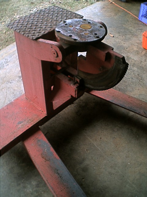

My new used engine stands
I currently have 7 engine stands. I bought the Matco 1000lb geared engine stand thinking I would put the Cummins out of the tug on it, I THOUGHT WRONG!
My buddy Daniel bought the Napa geared engine stand. the Matco & the Napa look the same except for the paint color. Neither one has impressed us! We mounted a 8.0L V10 out of a wrecked Dodge 2500 on his Napa stand. It leaned quite a bit, and sways whenever you touch it. He put a 4x4 post under the block to brace it up. The Harbor Freight 2000lb stand is much sturdier than either of the geared stands we bought. The Napa, Matco & HF are all made in China
At some point I'll get the Cummins out of the tug, so I bought these.
A Kiene Model 900 5000lb rated diesel engine stand and a Bacharach diesel engine stand. The pics just don't do them justice, they are huge! about 700lbs each.
I put the Kiene on ebay last week & no takers. I put the Bacharach on this week. My wife needs to think I'm trying to get rid of some of the stuff I drag home.
I think the $129 Harbor Freight 2000lb engine stand is the only cheap stand I would put a 6bt on and feel kinda safe.
1stGen545 "That stand you built is a very nice piece of work!"

1stgen545

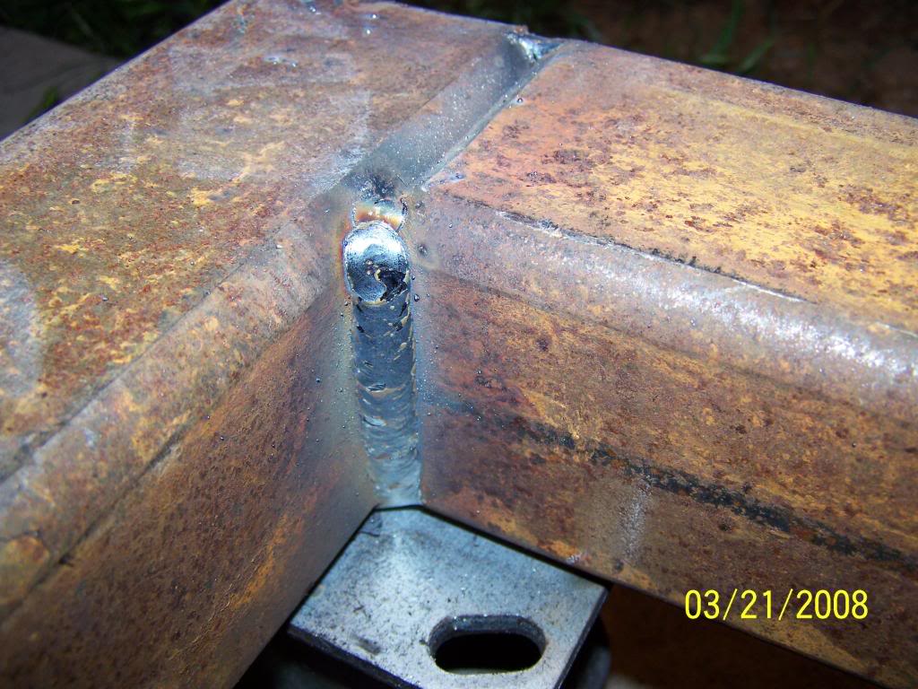

Nice job that is a good looking stand with lots of safety added in and the always needed shelf to set things on. Nice welds also --you can have all the steel you want but a weak/poor weld can kill you.

jimbob1111
thanks. We had stands like those at TSTC and would hold and flip a 855 Big Cam or N-14 cummins with no prob.
rattlerbob5.9

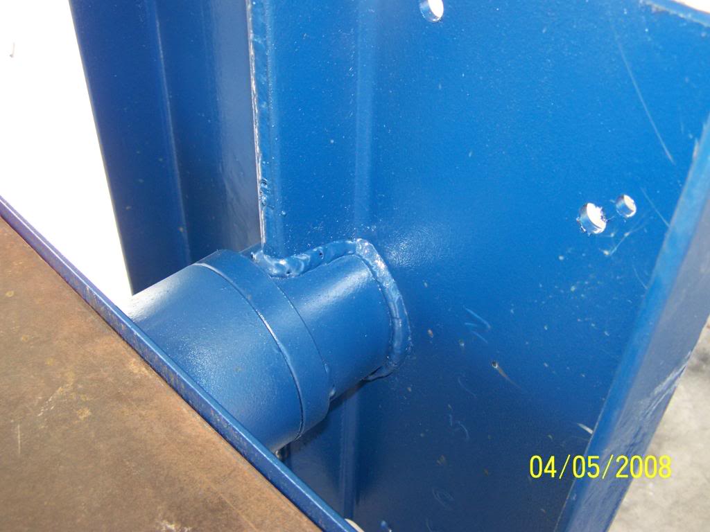

thanks I agree about the welds. I even left the ends of the 3x3 open so that I could add removable trays later
I got to use it the other day to strip down a complete 5.9 and now has a block with 14mm main studs ready to reassemble after it all made a trip to the machine shop. I will get pics of it all. even though i don't have the gear to turn it over on yet it was easy to turn over by hand with a complete engine.
