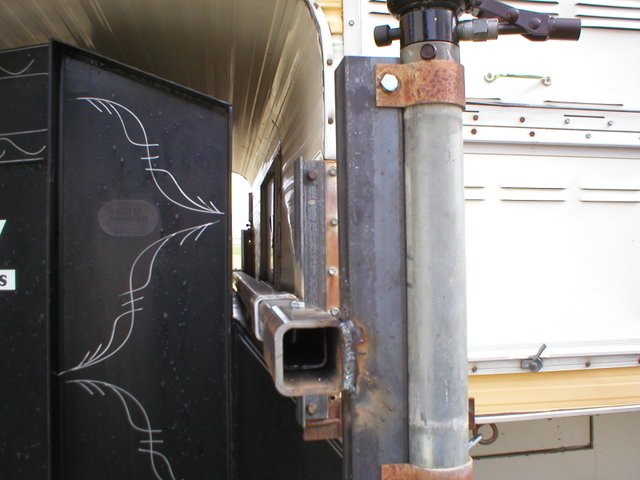

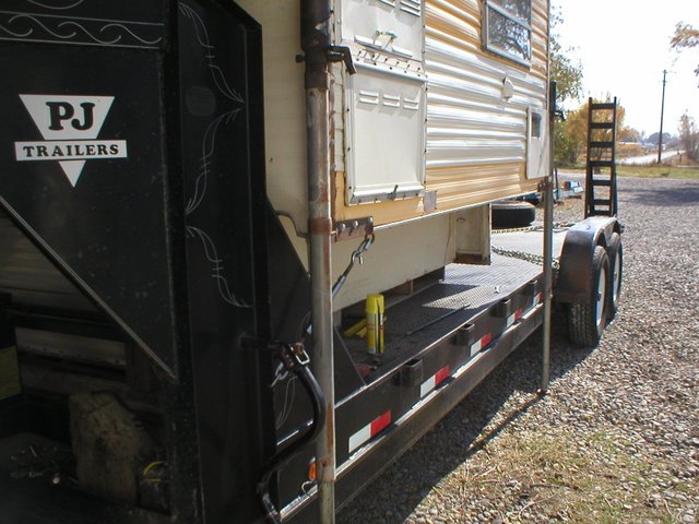

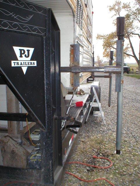

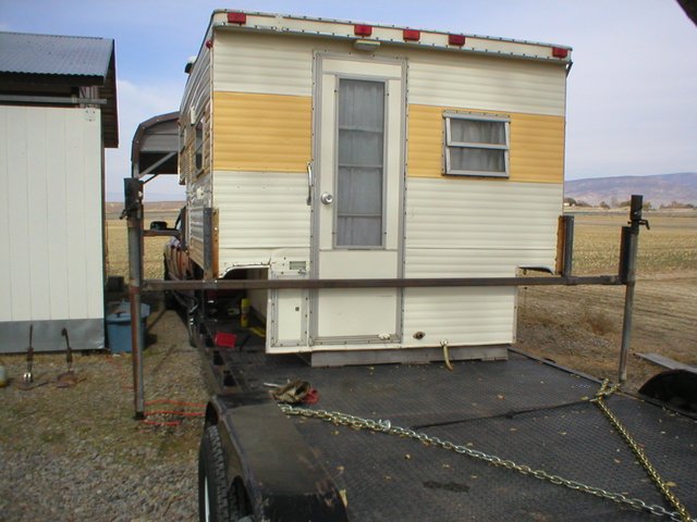

Here's what I came up with using 2x2 x 3/16" sq. tubing (20'), 1/4" wall receiver hitch tubing (3') and 2x2 x 3/16" angle iron (12') --
BEFORE
AFTER
As you can see from the rear view I can't open the door until the camper is sitting down and the cross-tube removed BUT I will probably put a 'drop' in the rear tube to clear the bottom of the door or just set it on sawhorses once it's off the trailer.
