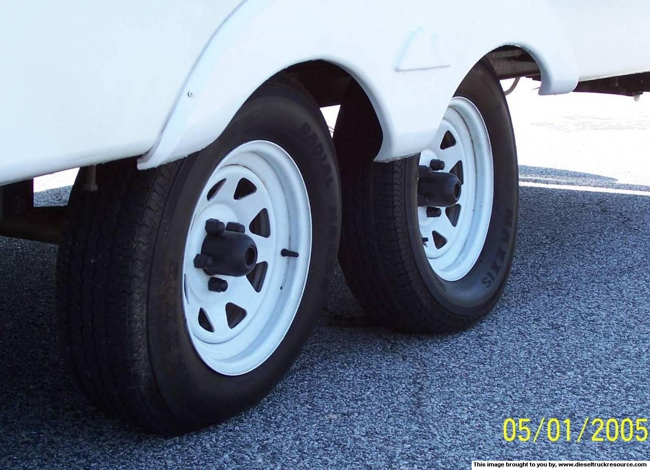

This is a statement I agree and disagree with. I'm not against the sliding hitch,,,, just 90 degree jack-knifing! When my Dad switched from long-bed to short-bed, I advised him to get the slider "just incase". Not for getting into a spot, but for getting out of a spot. My only reason for this statement is "If you need to jack the trailer to that degree(90 degrees) in order to get into a spot,,,, You need to find another approach or find another spot." JMO,,, but I feel it's way too much stress on tires, axles, suspension parts and pinbox of the trailer, not to mention the stress it puts on your hitch itself. One axle set of wheels sliding sideways on level ground is bad enough, but toss in possible unlevel ground, a tree root or two, and the situation gets worse. Below is a picture of the wheels on Dad's Cougar during a lock-lock turn while moving forward with the Reese sliding hitch in the forward position. The tires looked like they were ready to pop off the rims.

This is with the hitch in the forward towing position, in a lock-lock forward moving turn, on level ground.
Very true and as Mike stated,,,,, one time of NOT paying attention could cost big bucks in repair to both the truck and trailer. I have towed two different 5ers with two different short-bed trucks and never had a problem by not having a sliding hitch. I feel confident in my set-up which I've become accustom to. However, if I move to a bigger 5er in the future, which will probably have the shorter factory pinbox, I'll need to research my options again.
