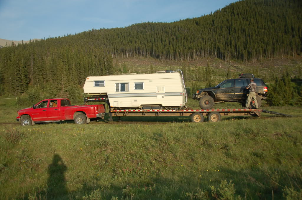

You didn't read my first post close enough, I've got a "redneck toyhauler" now.
Trying to simplify/lighten things up a bit. Its deck is 30ft, weighs in around 17K with the Jeep on it and isn't really practical to go on vacation with it without taking the Jeep. Works pretty good for local random camping but would like something lighter/smaller for more longer trips.
