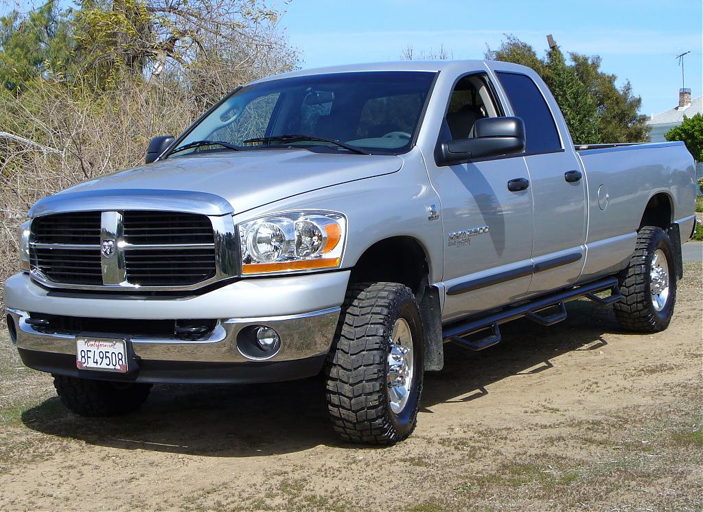

Old Feb 26, 2009 | 01:04 AM
diesel4play's Avatar
Joined: Feb 2009
Posts: 289
From: SoCal
Here is what the 305/65/17s look like on mine.
