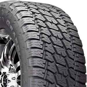

I know a few guys runnin these nitto terra grappler AT's and they seem to love them as for a 33 12.50 they dont come in but they do come in a 285/65/18 which is pretty dang close to a 33.
Attached Thumbnails recommend street tire and rim combo for 33x12.50x18?-tire.jpg
