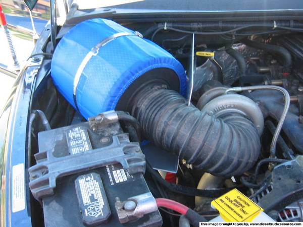

here's mine in the pic, not too great though. and i also posted a link with a better pic.

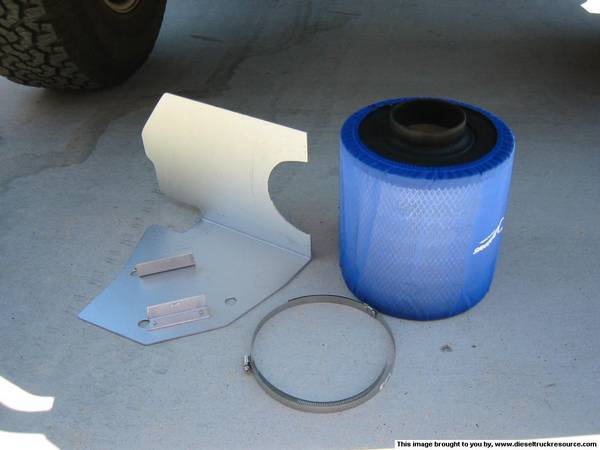

Here is mine.

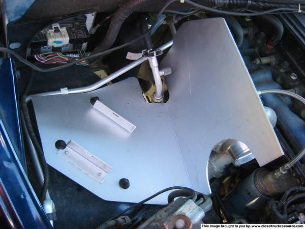

Using the template previously linked:
phox

thanks a bunch that is perfect
