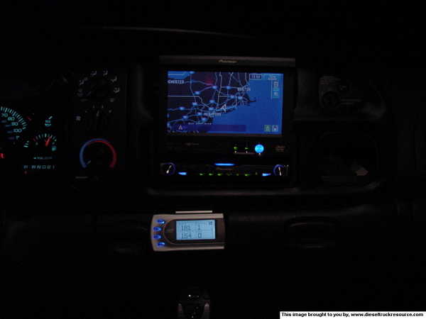

Make sure you hook every sensor up like the fuel pressure sensor most of all. It is pretty easy, plugs and running a few wires. The fuse taps arnt great it will look like the fuse is not in good but push it good it will stay. Other than that not bad. Where do you plan on mounting i, heres where I put mine. O yea get the hot unlock code

not sure where i'm mounting it i think my 5 spd. will be in the way or i would mount where you did that is a good place for it

It might, I would try it because they dont sell a pillar mount yet. I was gunna put it on the top of the steering colum but it blocks some of the idiot lights. I like not seeing any wires so it was pretty nice, I took out the cig lighter and made a grommet and ran the wire through the grommet. Do you have a performance clutch? You should fill out your sig so we know what you got. If you have a stock clutch you might not wanna tap the injection pump. If you have any questions during the install let me know.
