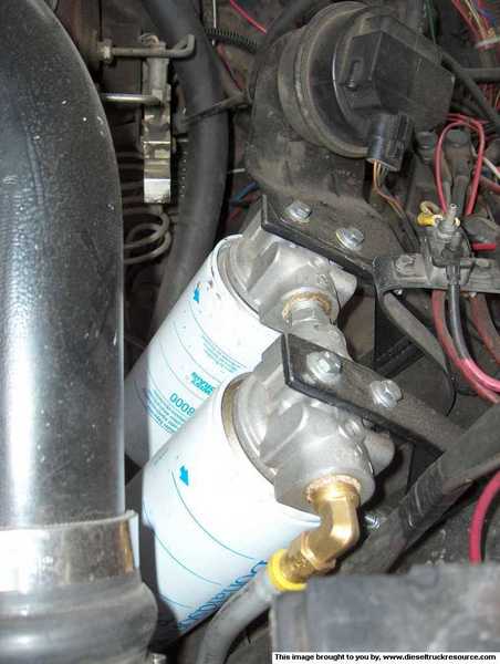

Yep the pump will have a real tough time sucking through a 2 micron filter. Better off with a 100 micron screen between the tank and pump, then pump through the fine 2 micron filter.
The factory filter is probably somewhere around a 12 micron, if you go to wix, fleetguard, donaldson, etc. and look up the filter they will usually tell you in the specs what micron rating it is. Also the factory filter has the fuel water separator.
Most 2 micron filters will be just that a filter, with no water separator. So if you want to filter to 2 micron you really need a 2 filter setup, the 1st being a ~12micron filter/water separator, then through the 2 micron, like this:
Except since this picture I remounted them so they are vertical, made a big mess when changing them like this.
