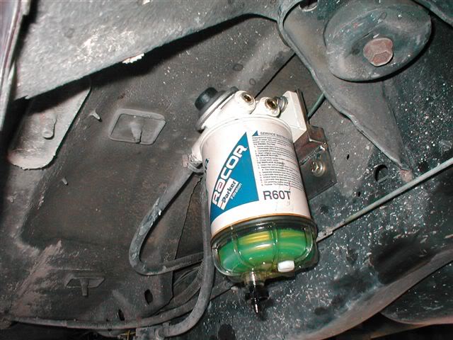

like this?

Yeah, i see you splurged for the Racor I was looking at a cheapo that can use many brand filter elements, but i will be carrying extra from now on.
How bad did it have to be to not burn? I think after mine seperated i had maybe 2qts total of watery fuel come out before i got the "gooder" stuff. From there i diesel 911, deisel treatement and 5 gallons of fresh diesel. I read that it reduces emissions......but i can't see the results...
