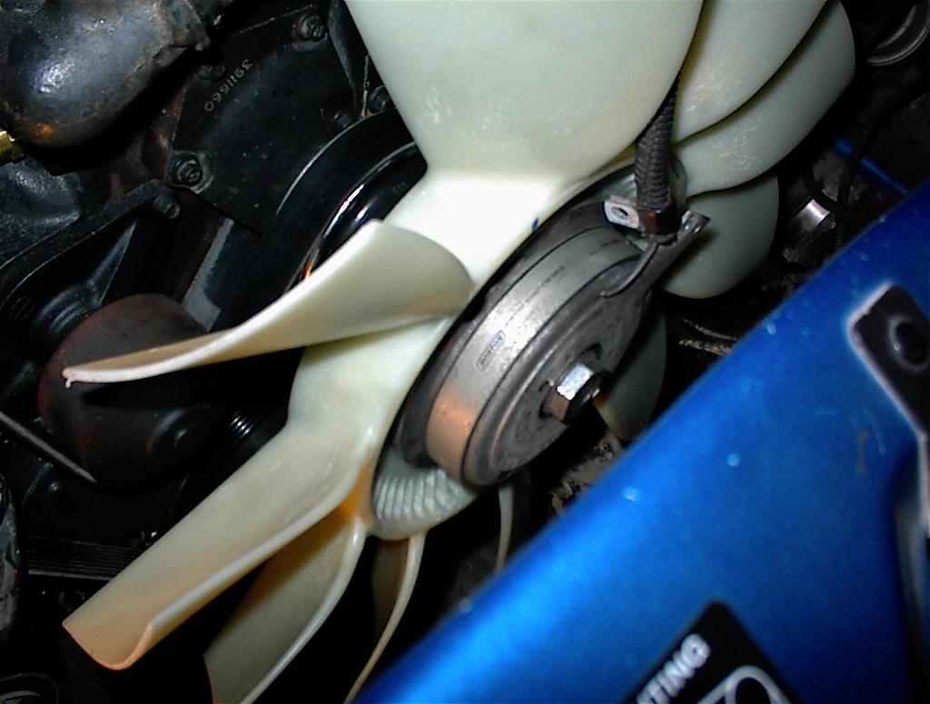

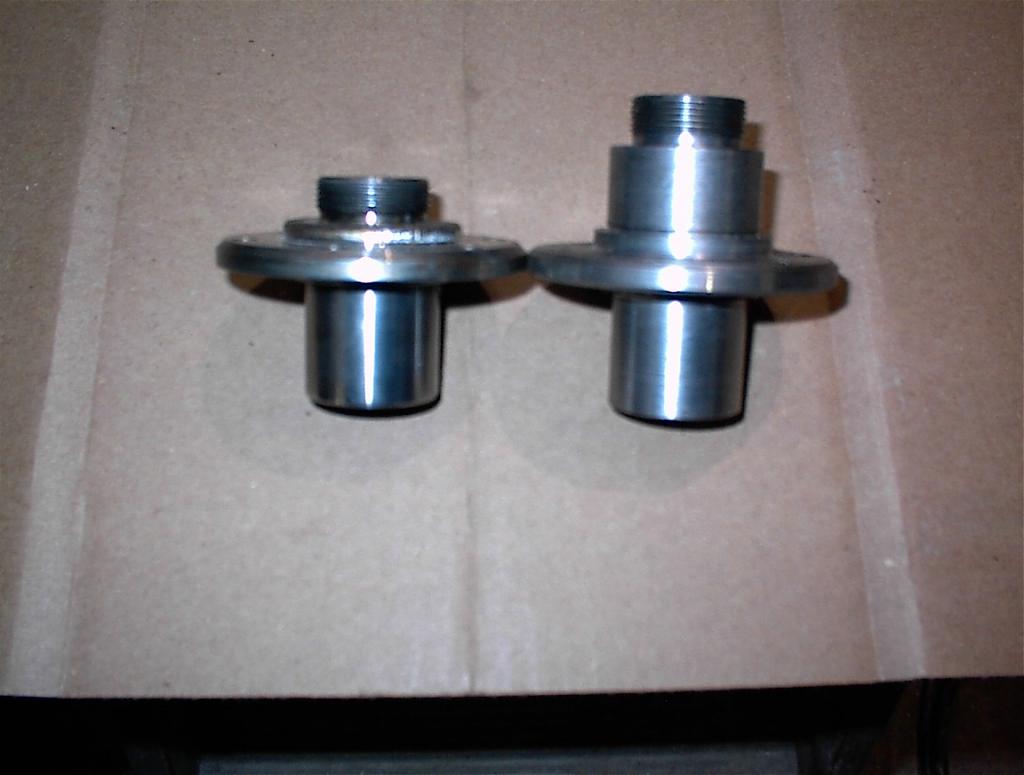

The bearing is replaceable I have had mine apart I made a longer new shaft for for mine to space the elec.clutch for the fan.this is a 12v but I think its the same part.
Attached Thumbnails fan mount bearing is going out-truck-rebuild-075.jpg   fan mount bearing is going out-truck-rebuild-076.jpg
