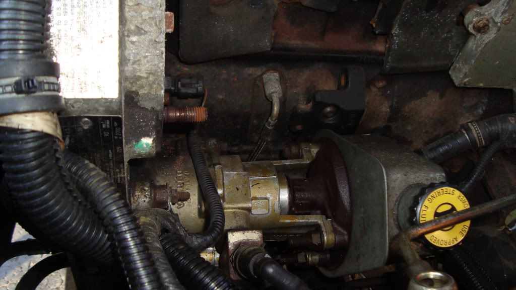

think that I found a picture of it with the vp44 removed.
I think this is the part number from napa that I need.
looks dang hard to get to.
ECH CSS712

That's it, and it's just about impossible to get to without either the VP44 removed, or the vacuum pump removed, unfortunately...
