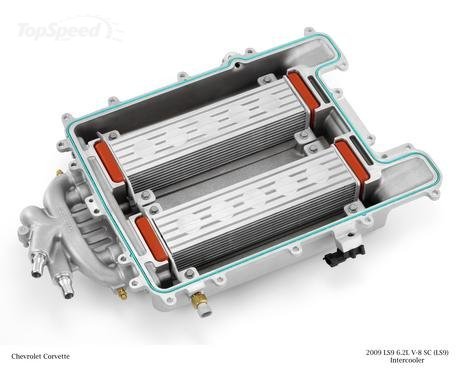

Do superchargers use/need an intercooler ??
Old Dec 13, 2008 | 09:14 PM
74dart's Avatar
Posts: 583
From: Shelby NC
Some do. You can buy air to water intercoolers for after market supercharger setups. The new Z71 corvette has the Air to Water intercooler mounted in the lifter valley of the intake.

Old Dec 15, 2008 | 04:33 PM
74dart's Avatar
Posts: 583
From: Shelby NC
Originally Posted by Tate
Cool, a 4x4 vette!
Sorry I meant ZR1 Here is a pic of the air to water intercooler in the intake.
