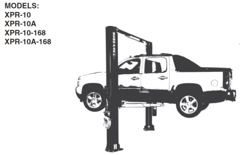

I have decided on two post thanks for the input! Now which MF (manufacturer)
Model: XPR10 BendPak XPR-10 Two Post Lift
10,000 Lb. Capacity / Clearfloor / Dual-Width
Rotary:
SPOA10X
10,000 lbs. capacity
asymmetrical lift
Any thoughts on these two?

well if you have friends that have a 6.0 powerstrokes then your 2 post lift will be unavailable for you to use . I have been debating the same thing and after seeing a few 2 posters fail I think I will get a 4 post and some tall stands for holding the truck up for front end /axle work .my.02

I am pretty sure that I will go with the BendPak XPR-10 Two Post Lift 10,000 Lb. Capacity / Clearfloor / Dual-Width
or the BendPak XPR-10A
and a tall axle stand.
I don't really know which to go with, the symmetrical or Asymmetrical with the 30 degree twist on the post. Any thoughts there?
