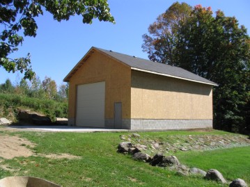

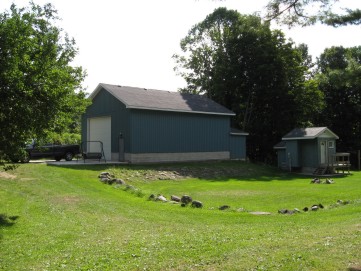

Thought I might add a picture of the garage. I built it to put my fifth wheel into so there is plenty of height. it has a 30'x40' foot print.
