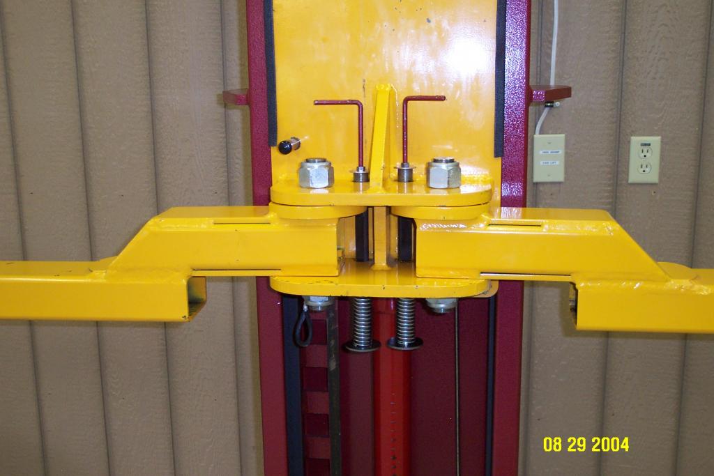

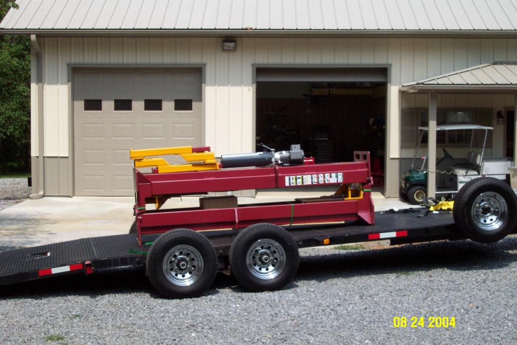

One thing about the 4 arms that swing in and extend on the 2 post models is that I have used mine to lift all types of stuff. Riding lawn mowers, ATV's, etc. Heck I have been wanting to make a pallet like attachment for the arms so I could raise items up to my truck bed. Still on my to do list.
The only thing I can say is, don't go cheap on a lift. I watched a shop doing some muffler work on a diesel truck and the mechanic was tugging back and forth on the exhaust and the truck was swaying more than I would feel comfortable with. This was a stamped steel column type post. With the weight of our trucks go with the 10,000lb rating so you have a little extra in reserve.
I bought my Mohawk 10,000lb 2 post lift because it was made of heavy channel and had a large footprint. The lift carriages each had sealed roller bearings to guide the carriage up the columns. It has close spaced mechanical safeties and hydraulic locks built into lines. Uses a link plate chain not cables to lift the weight.
My ceiling is 14' at the center and 12' at the front and back walls. I have the garage doors follow the ceiling and the truck clears everything at full lift. You would have to close the door if you had a cap on the truck bed.
Not trying to sell you on the Mohawk but take a look at their site. A lot of good info there. Another bonus they are made in America of all things.
