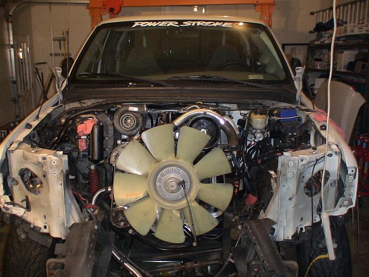

A couple pics of mine

On a side note add another 40 or 50 hrs on an OBS truck. If you want to use the cr ac you need to notch the engine cross member. I also installed a sd condensor so the ac lines are on the pass side.
You also need to notch the firewall for the engine to fit in the right spot. I'm sure I'll think of a few more things.
