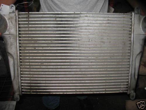

I have decided that the nearly new 2006 Dodge Cummins intercooler that I have isn't going to fit in the Jeep without major modifications to both the intercooler AND the Jeep. My original plan was to cut the bottom 7 rows from the core and weld close the bottom of the tanks. Unfortunately, the intercooler is too wide to fit between the ZJ frame rails and so thick that I won't have room for an AC condenser. If you know anyone who needs one of these intercoolers, I'll sell it for what I have in it - $150 + shipping. After more research and emails and measuring I purchased a 1999-2004 Isuzu NPR intercooler. The intercooler is significantly smaller than the Dodge Cummins intercooler, but should still be more than large enough for the QSB3.3T. I think I'll have to modify the inlet and outlet tubes, but I have a welder friend who can weld alloys in his sleep. Relocating the inlet / outlet tube(s) shouldn't be a problem.
The dimensions of the Isuzu NPR intercooler are:
Width at widest point (from inlet to outlet) – 29”
Width at 9" from bottom - 25.5" (lower part of intercooler that must fit between frame rails)
Height (from top to bottom mounts) – 17”
Depth (incuding inlet/outlet tubes) – 4.5”
Inlet and Outlet tube diameters - 2.75”
Core thickness - 1.5"
Core width - 20"
Core height - 14"
Tank thickness - 1.75"
Distance between tubes - 23.75"
Last edited by 95Z28A4; May 13, 2010 at 09:47 PM. Reason: Added Isuzu Intercooler info.
