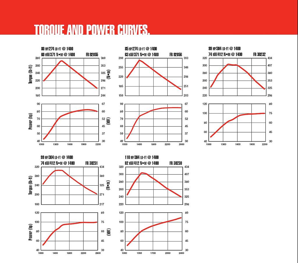

Picked up the engine from the FedEx Freight terminal this morning. I was a little disappointed. The engine Cummins Central Power shipped me is the 99/305 FR30231 not the 105/305 FR30230. I called them and asked for an explanation. As it turns out, the engine IS correctly listed on www.dieselenginetrader.com . The description of my ESN is incorrect in Cummins documentation. I asked them how they planned to make things right. The salesman told me $4100 is their cost for this engine and if I did not want it, I had the option to return it to them. I explained that shipping back to Iowa wasn't smart for either of us. In the end, he agreed to send me the dual groove crankshaft pulley for compensation. Even though I did not get the 110/305, I still feel I got an exceptional value for the price I paid.
After studying the torque and power curves, the FR30231 may be better suited for highway use than the FR30230. I've attached a jpeg of the QSB3.3. Comments are welcome.

Looks like your engine gets ~200 rpm more top end compared to the 110 version. That would make tranny/tire combinations easier to deal with. I kept the B3.3T 2600 rpm stock top end for awhile without problems (in fact I rarely go above ~2300 rpm). The 3.07 axles and AX-15 overdrive were good enough to reach speeds capable of getting a ticket on the interstate.
