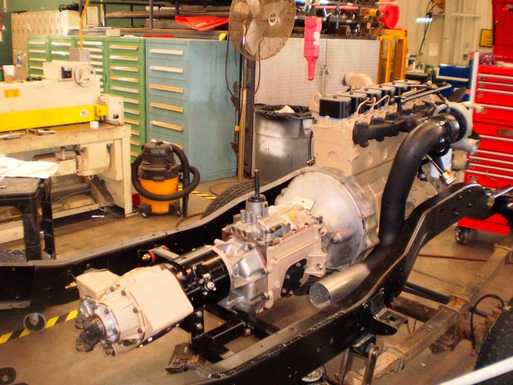

There is definitely not enough gears in a 727, top speed would be an issue. I have a 77 with a 5.9 in it. If i remember, i believe that you can buy an adapter plate for any first gen if you run a first gen transmission. If you are looking at running something newer like a nv4500, 47rh, 47re or 48re you would have to get an adapter from a second gen cummins. the plates are a different thickness and the starter clocking is different. I am running a nv4500 in mine and i must say, the overdrive is a must. Let me know if you got any more questions. I have been building this truck for about 2 years now, so i got a lot of info on this kind of swap.

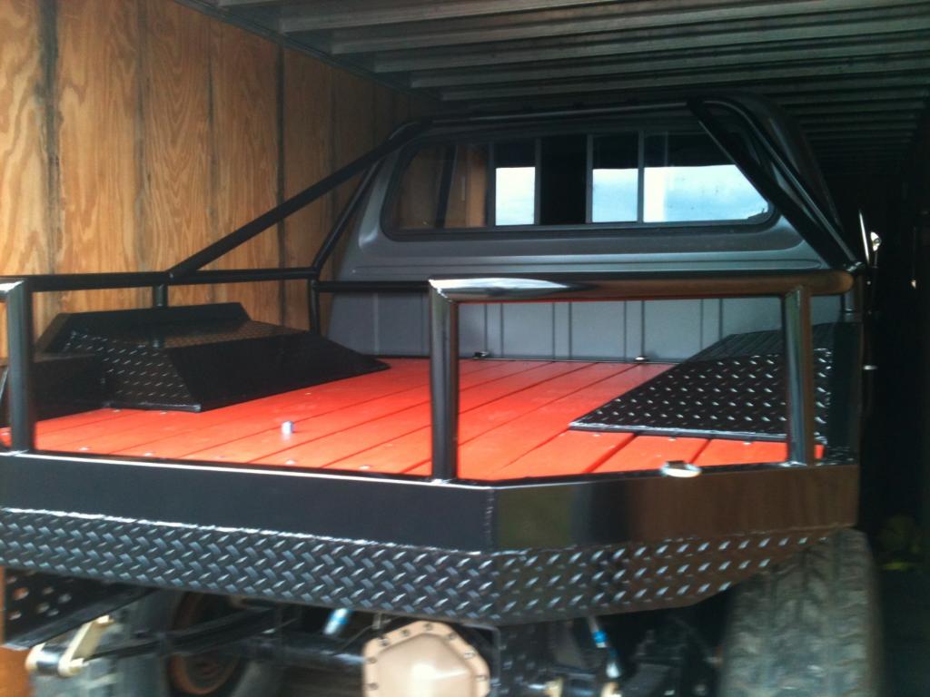

Got any new updates? I love your deck

Do you have a build thread on your truck? Details on the suspension? I like it!
