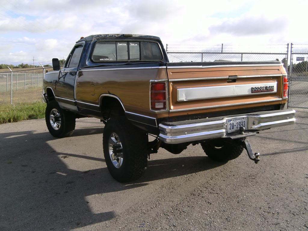

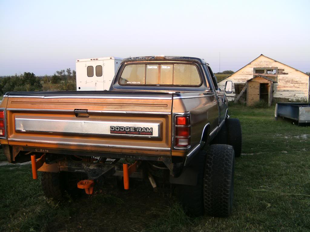

This is my hitch and sledbump setup, as you can see the hitch is moved a foot forward,I would dump the rear bumper for pulling and get your hook point as far foward as the rules will allow. This will help reduce bounce and keep the front down
My truck goes from this
To this when the pullin season is over
As far as front bars, go for it if your rules will allow it

3.5" hitch hole is pretty much the standard nowdays
