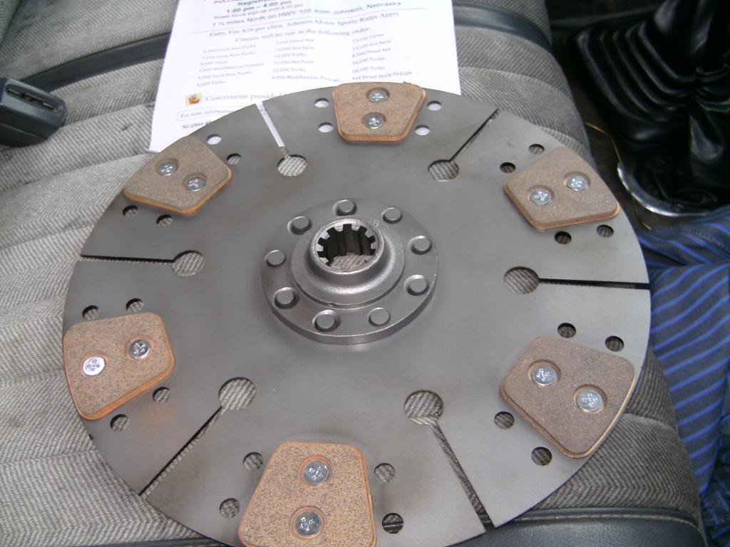

Your clutch should be up to the task. Heck I'm only runnin a single disk, but it is a full ceramic, solid hub, button disc.
Here is my clutch
Watch my vids and study how I come out of the hole, it seems to work for me coming out softly. This year I might come out a little harder though.
Here is my clutch
