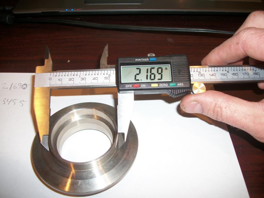

I just measured the inside of a 50mm wastegate. Its 43mm internal diameter, just about the same size as the entire volume of a T3 turbine inlet flange
Attached Thumbnails Twins, Twins, Twins, Twins, Twins............-wastegate-001.jpg

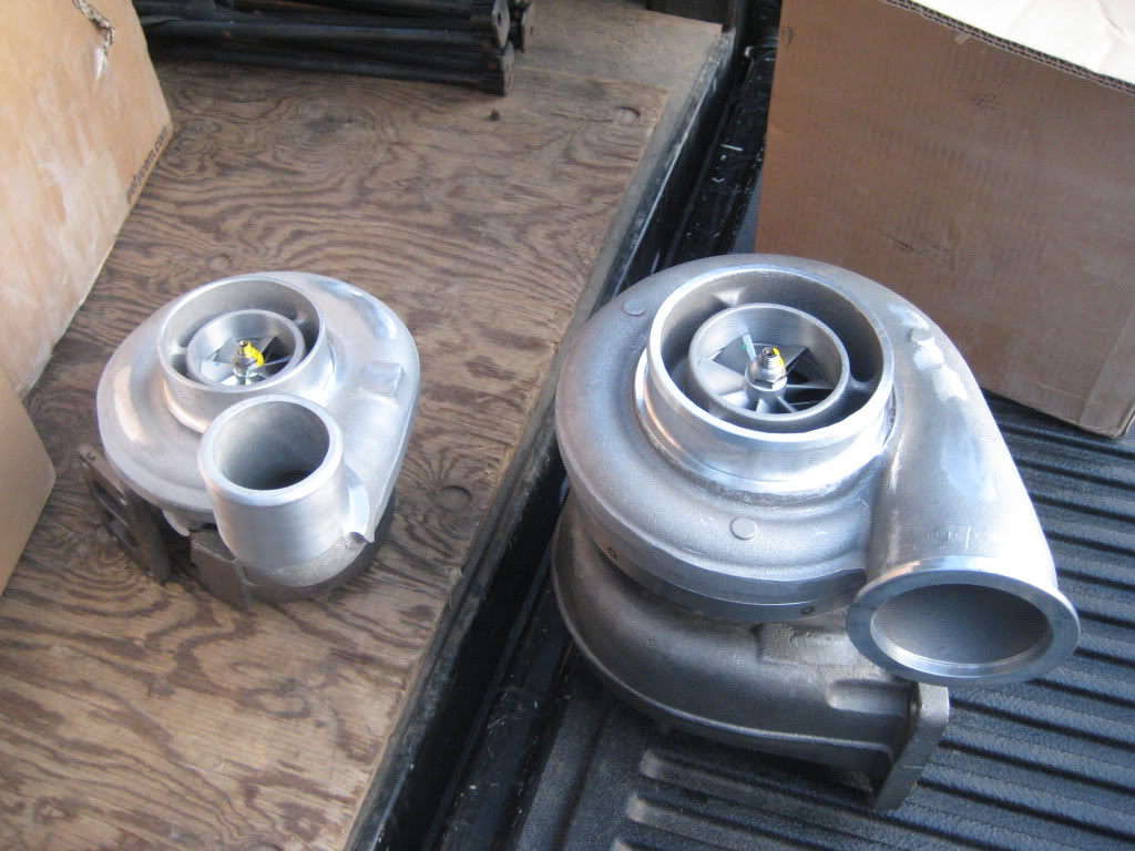

GT35 is $1200 (maybe cheaper if we buy two). 92mm turbine S400 is $1200. Steed Speed manifold with wastegate stand is $700. So you're looking at $3100 in hard parts. If you go with the cheaper S400, you'd be right around $2500. Have to add in a wastegate as well, which is in the $250 range depending on size and brand. Not sure what ASW is gonna charge for the labour, but I am betting it would still come in under budget.

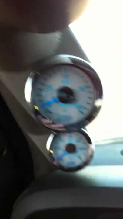

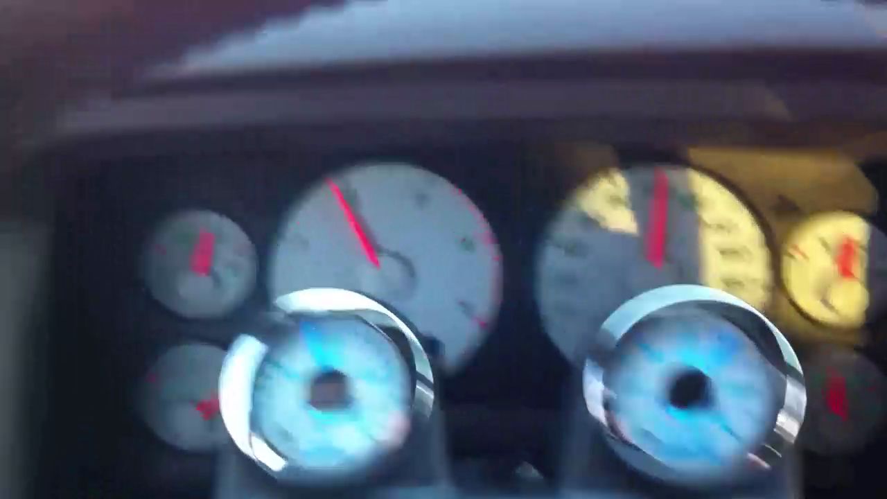

Just thought I would post some video of the spoolup on my setup, the video is kinda shitty, the road was bumpy. 6th gear 2000rpm roll into throttle to about 2/3's. Smarty on Sw-4.
http://i166.photobucket.com/albums/u...t/7883ef71.mp4
http://i166.photobucket.com/albums/u...t/cdb26b91.mp4

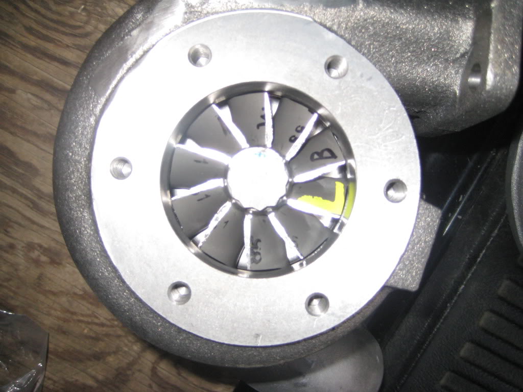

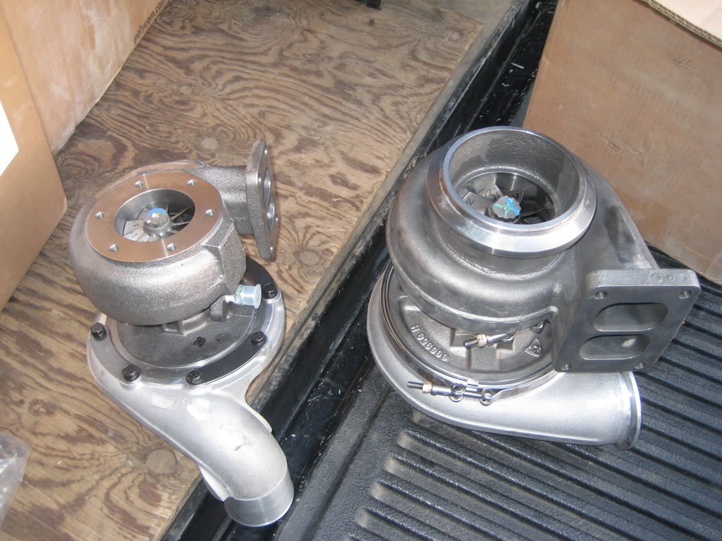

This is a 62/71 over 74/88, no wastegates, secondary turbine wheel trimmed

Goatbrain, Looks like the V-band on the turbine end was machined off. I would have left it on. Makes installation easier. Bolted flanges are nice and I use them myself, but V-bands are so much easier.
How much load you have on the primary? Looks like a sweet set-up.
Old Apr 7, 2011 | 08:29 AM
  #90
goatbrain5.9's Avatar
Posts: 116
From: Edmonton, AB
Seeing about 50 out of the primary and 20 out of the secondary
