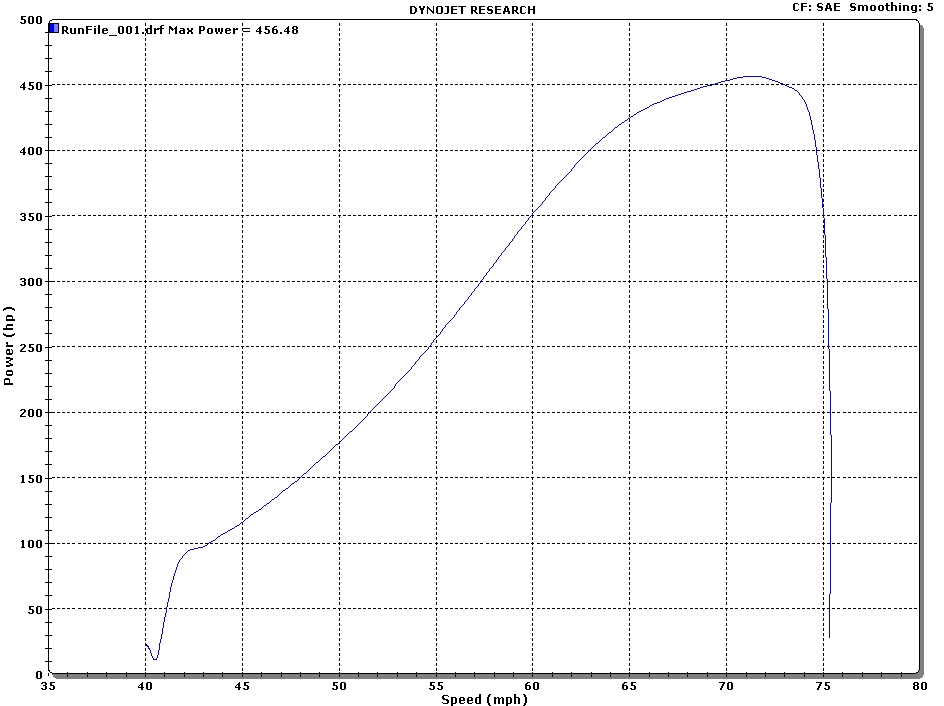

My brother-in-law dynoed a 12v with the BD twins the other day. It made 450hp. He said it had 3.5 GSK kit, cut delivery valves, small plate, 80 HP injectors, ARP studs with a stock multi layer gasket. He also had a NV5600 6 speed. They had to hand calc the torque but it was 970 ft-lb. They couldn't get a tach signal for some reason.

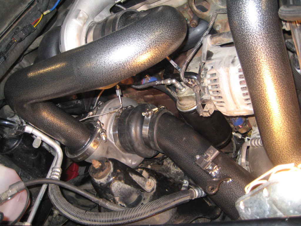

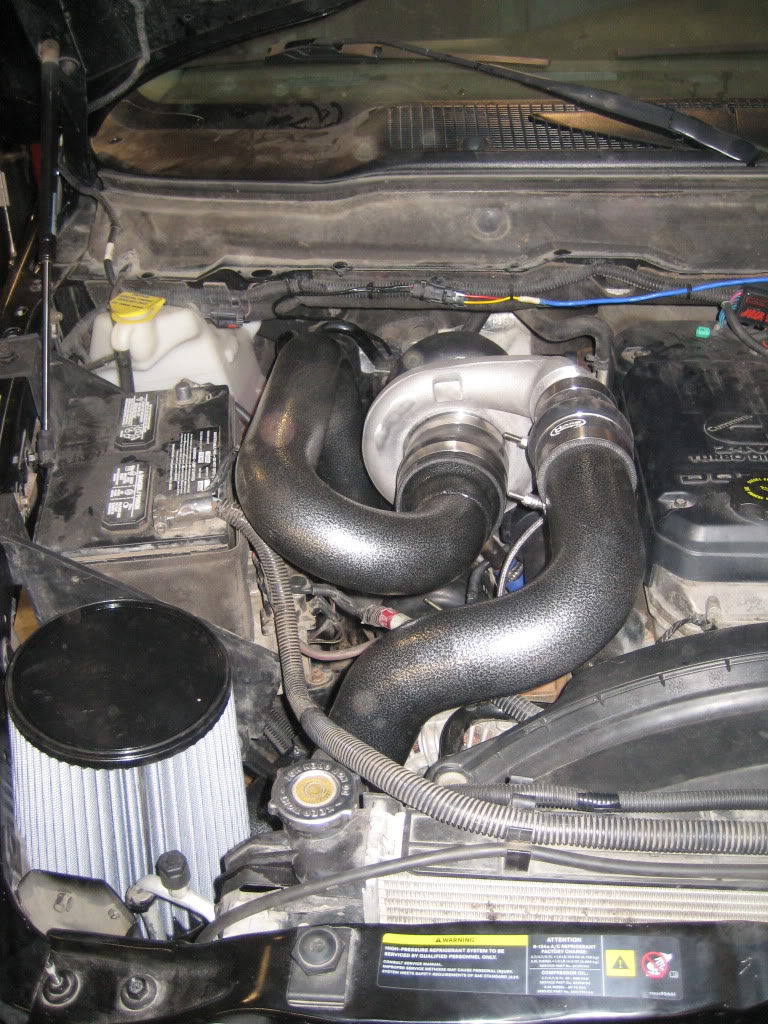

If your looking at going the twin kit route, you can look into DDP, they make twin kits. I've got one in my truck and it spools really quick. It's a 62/71 over 74/88. Smaller turbo's turbine has been trimmed. With 90's it's super cool and tows very well.

I forgot to mention that they build the kits specific to your truck, it's not just a "one size fits all kit". You tell them what your planning on doing with the truck and they build accordingly........... Just some more info for ya
Boy thats a nice looking install. I like the short run from the primary to the secondary compressor side.
