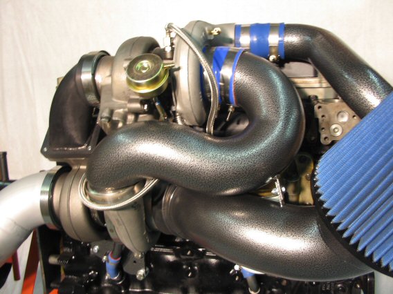

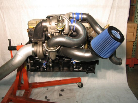

The source kit is pretty....
Attached Thumbnails Twins, Twins, Twins, Twins, Twins............-3rdgentwins.jpg   Twins, Twins, Twins, Twins, Twins............-20.jpg
