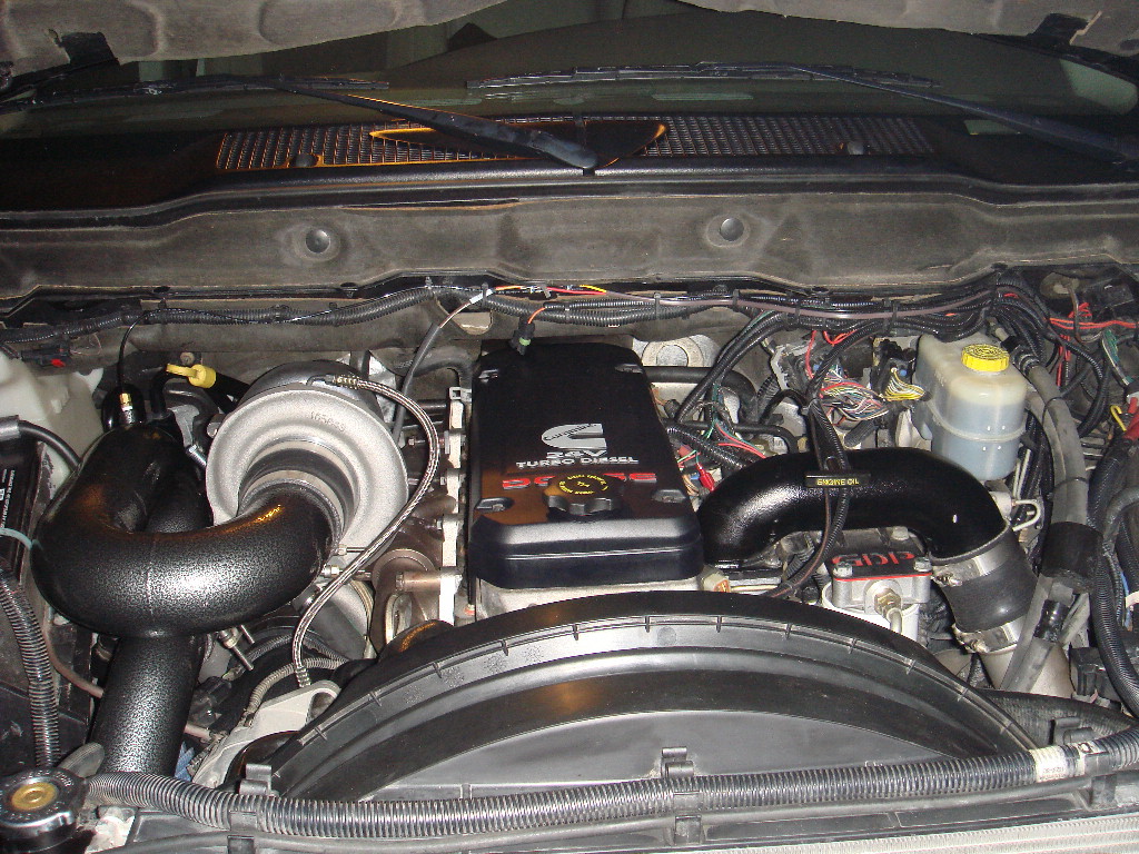

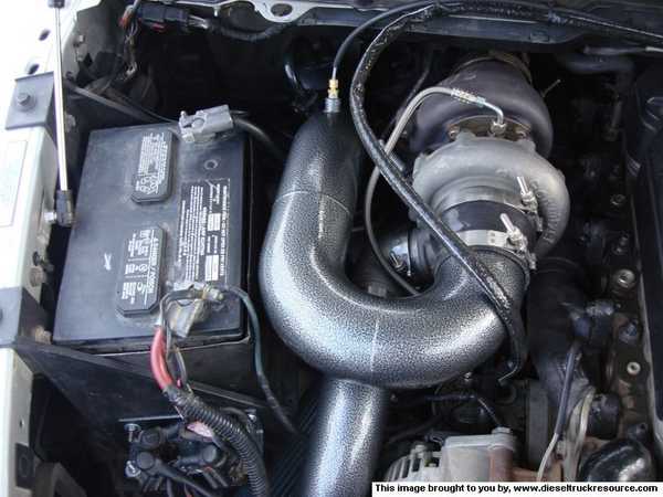

I like the looks of that DDP kit. I'm sure the boys can make their filter fit well in the corner.

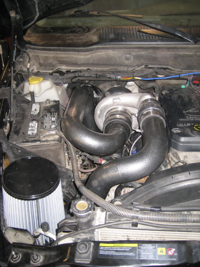

The nicest looking Cummins twins are likely the MPI twins out of Idaho.
Traditional layout with all the piping down low & no air filter heat shield. They are not the cheapest though..
