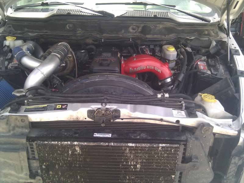

Twins installed and just about ready for test drive:

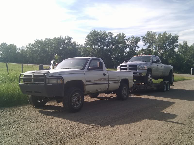

Tate getting to do tow duty after 3rd gear went bang:
I will try and get an overview shot of the final install engine bay soon, thought that Trevor had one, but we must have been so excited to go for that test drive that we didn't get there.

Tate present.............................and something goes bang.
Hhhhhmmmmmm. Seems to be getting to be a common denominator in that statement.
Tate's always been a great help to all -- from me, thanks for all the info over the years.

That trailer was getting some use for sure. Still has some heavy parts on it, little less after ripping on it yesterday.
Tate does help out a lot. The "pusher" helped me with a fix yesterday.

Thanks for coming down and helping rip and tear on it. Other than my red neck and a bit of blood loss, it was a good day. Got some more stuff off it today, just need a place to dump the diesel out of that botched tank. Anyone want some free diesel?

That does look good & thanks for the pics. It looks like that truck went together way quicker than mine did!
I'm surprised that the G56 let go as those are holding up qute well even though I prefer my NV5600.
I do see an aftermarket clutch fluid reservoir so I'm sure the lame stock DMF & clutch are long gone.
What were you guys doing when it broke 3rd? Did the rear tires lose contact with the ground?
That tach needle looks like the 2006 Dodge Ram cluster gauge issue that is common. The tach quits working & the fix is a new cluster from Chrysler.
Interesting install on the fuel pressure gauge sender. Geno's has a really nice polished aluminum piece with a 1/8" NPT port. So much better than the plastic piece.
http://www.genosgarage.com/prodinfo.asp?number=LT_FFCPP

It has a SB DD clutch, tires barely chirped in second, and did not give at all on that hard / fast 2-3 shift. It is not a big power truck, but it is heavy and has lots of traction. It dyno'd 434whp iirc, back in May on the stock charger and SSR, it was probably only about a 450whp tune when it broke 3rd gear.
I saw the geno's garage piece, but for $60 and having to wait a week or so to get it, the 3 min of: Remove, drill, tap, clean, thread tape, re install, was a better option for us.
Yes it has the infamous 2006 cluster issue, thankfully as Tate pointed out he has an '07 mega cab CR one to try in its place.
I also wanted to point out that pictures are a little deceiving, there is quite a bit more room between the battery and the cold pipe, more so then what it appears in the pictures. We installed the battery with the cold pipe already in place. The reason for the boot around the pipe, is Trevor doesn't have any battery hold downs, and rather then risk having a battery jump up on the test drive, we just decided to do a quick fix.
