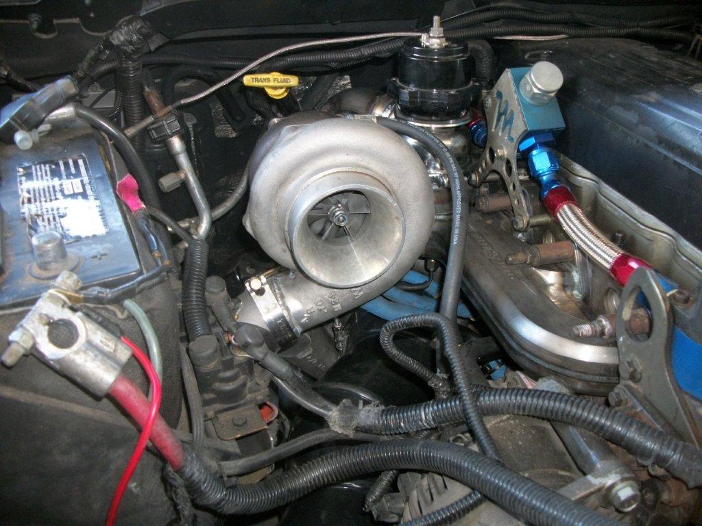

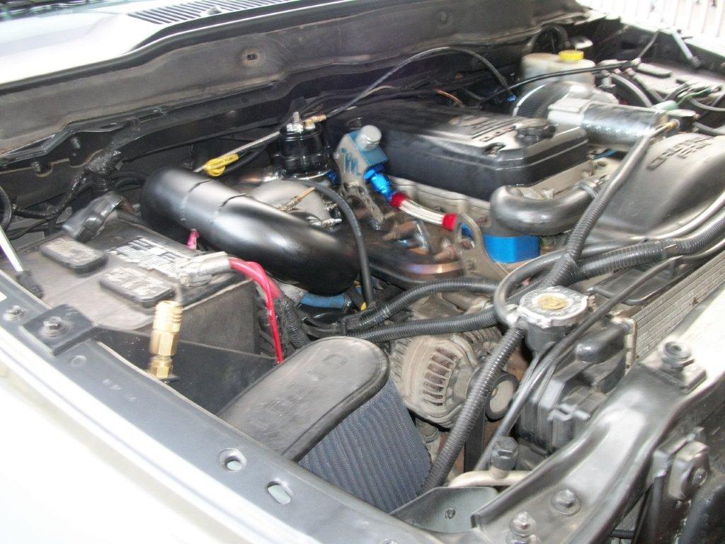

New twin build pics for everyone.
Attached Thumbnails Twins, Twins, Twins, Twins, Twins............-twins1.jpg   Twins, Twins, Twins, Twins, Twins............-twins2.jpg

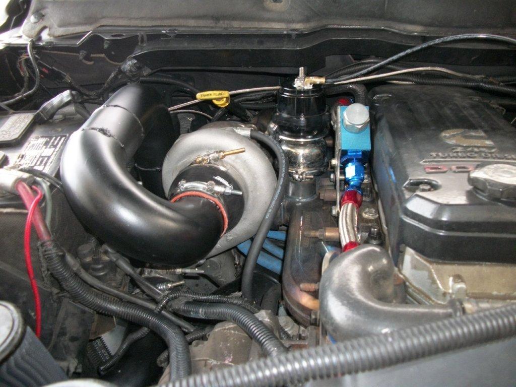

Few more pics. Wanta send out a big thanks to everyone. Tate and Brett, tons of fun. Glad everything worked out good on this build.
Attached Thumbnails Twins, Twins, Twins, Twins, Twins............-twins3.jpg   Twins, Twins, Twins, Twins, Twins............-twins4.jpg

Hey Tate, Brett and Mike, how did that ATS intake hose work?? Was there any clearance issues between that intake hose plumbing and the straight intercooler tube that comes off the Garrett and goes to the intercooler?

It worked perfect, it is what I will use on all similar builds in the future.
