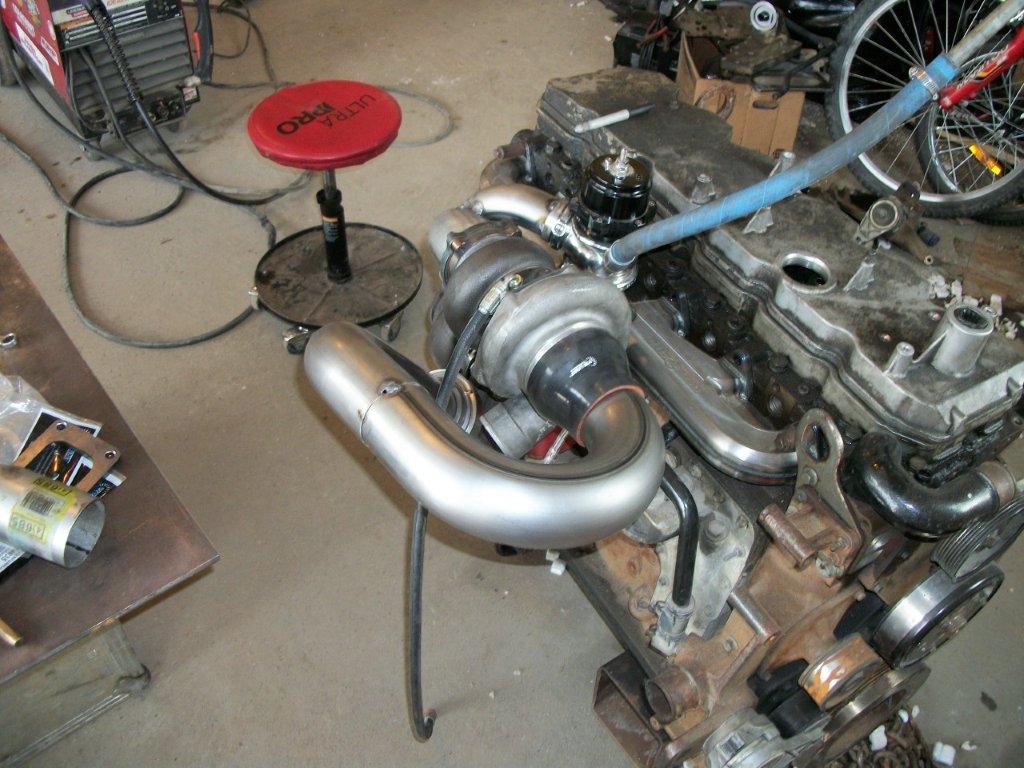

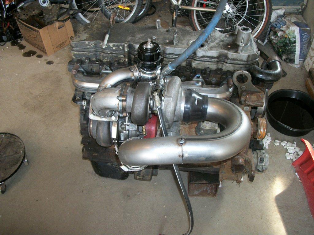

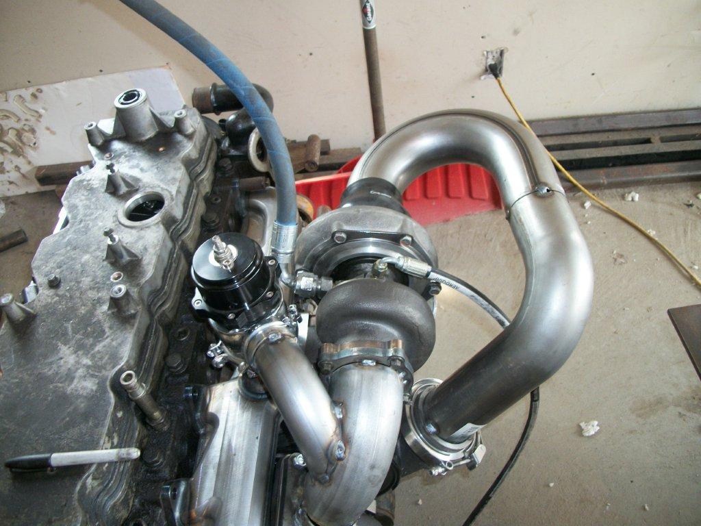

Here are a few new pictures fresh from the Airdrie Sunk Werks fab shop.
The twins are just tacked and we need the trucks to make sure the fits are good to burn wire.
Build two sets yesterday, just have to get a few more supplies for Jamies truck. Should work pretty good, even had Tate throw on a 24VP gearbox onto a 03 CR engine on Friday for kicks and giggles.
We are going to build a 6.7L with a 12V gearbox so you can run a pee pumper.
Attached Thumbnails Twins, Twins, Twins, Twins, Twins............-june26newpics-037.jpg   Twins, Twins, Twins, Twins, Twins............-june26newpics-038.jpg   Twins, Twins, Twins, Twins, Twins............-june26newpics-039.jpg

Looks awesome Mike!!! Just curious how you are gonna tie in that Garett water line?

Stainless banjo lines, you'll hardly see them and they will be shiny. Everything is tacked, so if required you can adjust things to fit properely. We have one truck next weekend getting a set of twins installed. 06 dually, going with the stocker over a S475, of course there are a few turbo tweaks. That truck is running the SSR smarty, so it will be interested what we get for power find.

Wow, nice job guys.. That manifold makes all the difference.

Ya the manifold isn't a standard steed piece. Its been adjusted to our specs. First non-divided T3 flange manifold that has an external gate.
The wastegate has also been adjusted to increased flow. Its a nice piece. I have a few being built for a few SDX 2.6 trucks.
