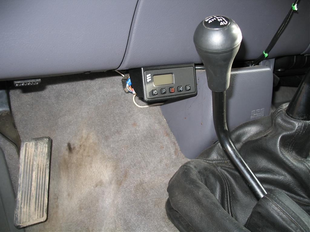

tate is going to give me a hand installing it on saturday. he's done a couple so hpefully things go smooth. i have to meet up with him so he can see the kit contents - sounds like my kit and his are a bit different as far as what parts are included. also, my unit has an external fuel pump - his is internal. maybe they have changed things over the years . . .
any tips/advice on the install shane? where did you mount unit and 7 day timer?
i am plannig on mounting the timer to the right of the driver on the solid panel directly below the flip-down ash tray
Old Dec 10, 2009 | 01:07 PM
  #132
Lil Dog's Avatar
Joined: Feb 2002
Posts: 6,102

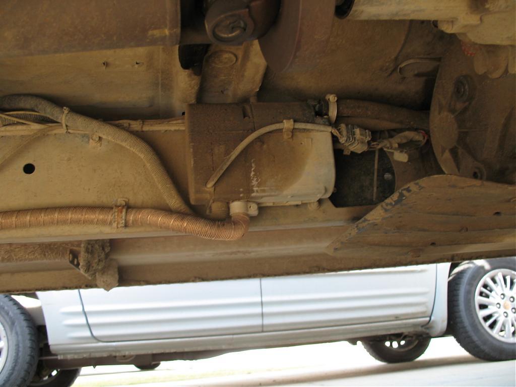

You will love it J... Its just soo darn handy..
This is where I put my controller. The mount came with the kit..
Shane said this location doesn't work on short boxes due to the fuel tank position.. But mine is on the drivers frame rail by the transfer case..
Yes, they Espar did make that change as some people were having issues. Trying to pump gelled fuel too far. I dunno really.
My heater is mounted in the engine compartment. Believe me, there are not a lot of places to mount this thing on a shortbox truck. A long box is a different story. My timer is in the glovebox.
