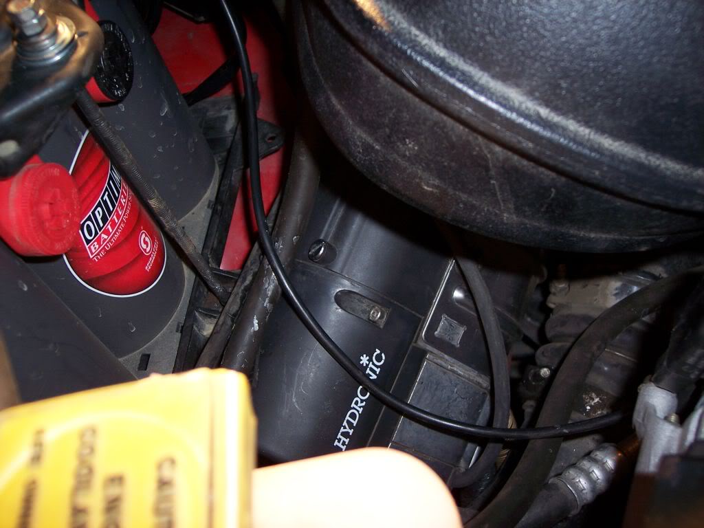

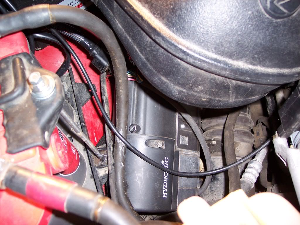

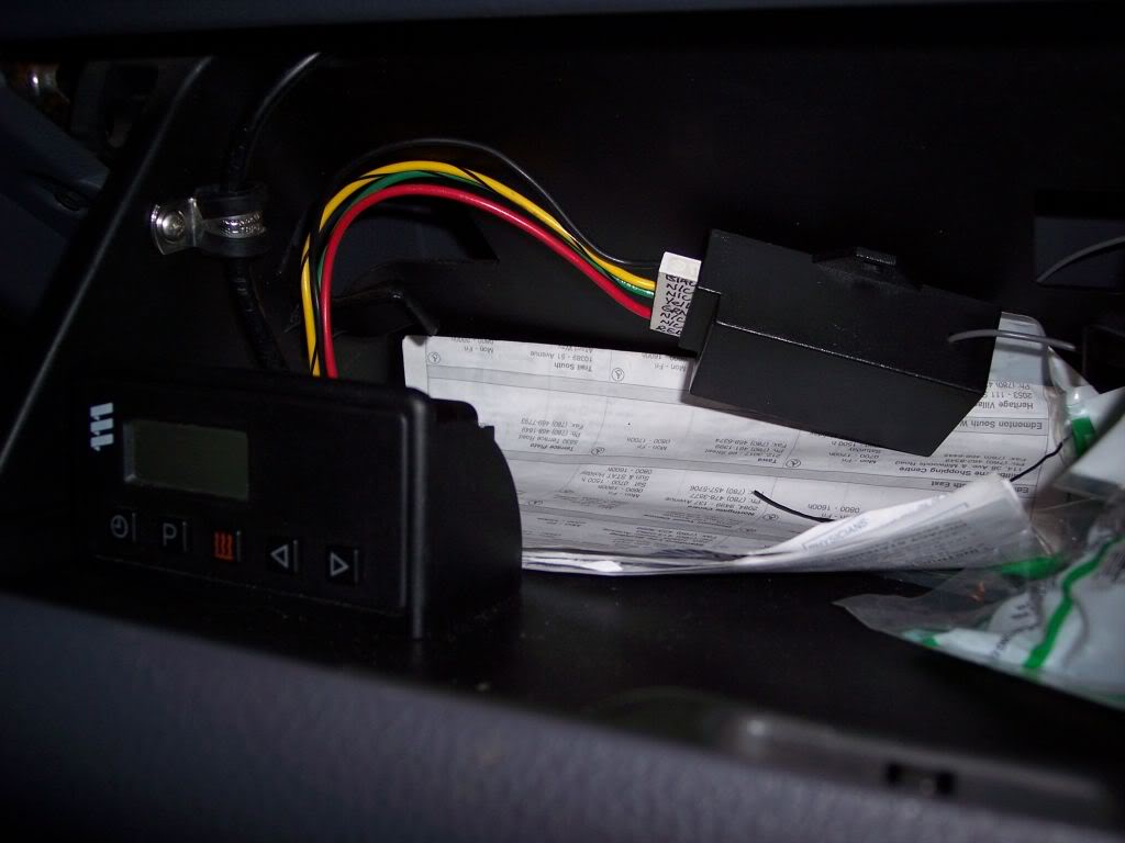

Mine is kind of hard to see since its partly mounted under the battery tray and on the fender. Like I said, room is limited on a shortbox truck - or at least that was what I found. Anyway, I snapped a couple of pics for you:

What kind of intake are you running? Whats the black box just prior to your timer? Looks like each of our kits are different.
Stage 1 AFE with the torque tube (which is a pain BTW).
The Black Box is the radio reciever as I also have the keyfob remotes.
