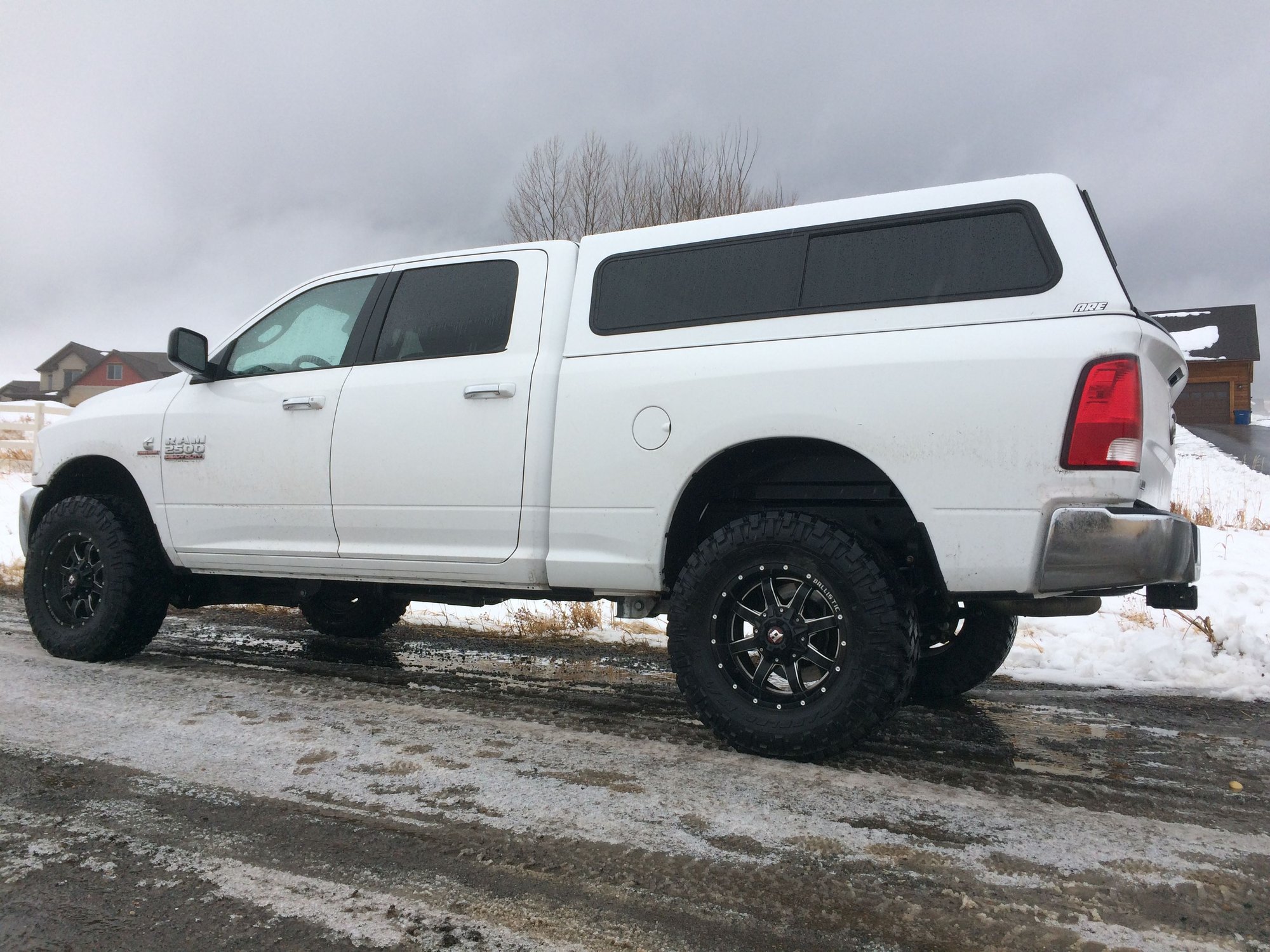

Picked up a slightly used ARE for $1000 just after posting this. Also got new wheels and tires a couple of days prior, killed my MpGs

Looks good. I have a Leer same style. Love mine 90% of the time. Nice to be able to keep stuff dry, safe and snow out of the bed in the winter. I have a long box and was going to say a full size cot fits perfect! But I see you got a short box. I elk hunted out of mine for a week on a solo hunt. Was perfect and easy to move camp. I think I saw some 6' cots on sportsmanguide. Sure you can find one somewhere.

Thanks! Now I need fender flares and a leveling kit (tires rub a bit even though they are only 1" bigger than stock- backspacing I guess). Fun never ends.
